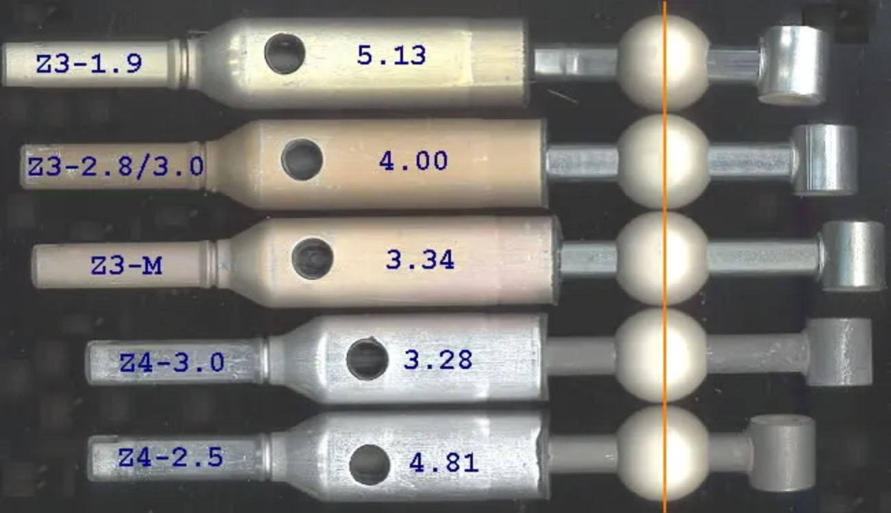

Whilst I was doing this work I also wanted to make the car slightly easier to drive - it was always quite a stretch to get 3rd gear from the drivers seat. I though fitting a lever with a shorter throw would reduce the distance forward that the lever had to be when in 1st/3rd/5th.
Being used in BMWs means there are a lot of options around for 'short shift' levers. Many of these options are aftermarket, and so cheap I suspect they are rubbish. However in my investigations I realised that many people thought the best option is to use the shift lever from a 1.9l Z3. The picture below shows the many different lever options from production BMWs. The movement ratio is written on the right, and the car it comes from on the left.
The ratio is calculated by the distance of the shift rod connector bolt from the centre of the ball joint, compared to the distance of the top of the lever from the centre of the ball joint. The longer the ball to connector distance the less hand movement is needed.

As you can see below the original Jaguar lever has a much shorter end. Its also worth noting that my lever is much more 'bent' (on the left) than the Z3 lever - I had it cut and re-welded when the car was built. I have not had the new lever bent - but I may still need to do so, to get it to fall to hand nicely.
Fitting the Z3 lever is simply case of dropping it in to the new lower bush in the shift platform, slotting the new upper bush around it, and then dropping the spring, washer and retaining circlip back into place.
