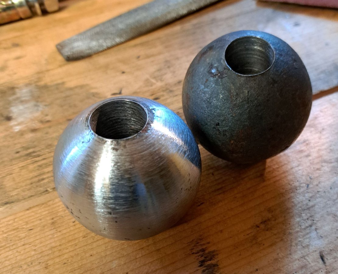

Using the Z3 lever caused another issue - The Jaguar lever has a threaded end for the gear knob, the Z3 lever just has a plain rod. I decided to try to make a new gear knob. I bought a couple of steel balls used for the top of railings and set about one in the lathe. I am very much a self taught beginner with the lathe so the results were not perfect
I cut a flat top on the ball for a gear shift pattern sticker; Cut a step at the bottom and drilled for a grub screw to attach the ball to the lever; and filed, sanded and polished the outside to get a nice surface. The hole in the ball was larger than the lever rod, so I got some poly bush material (polyurethane) and made a bush of the correct size so the knob was a tight push fit onto the lever.
Its now hard to move the knob on the lever, and the grub screw prevents any movement anyway.
