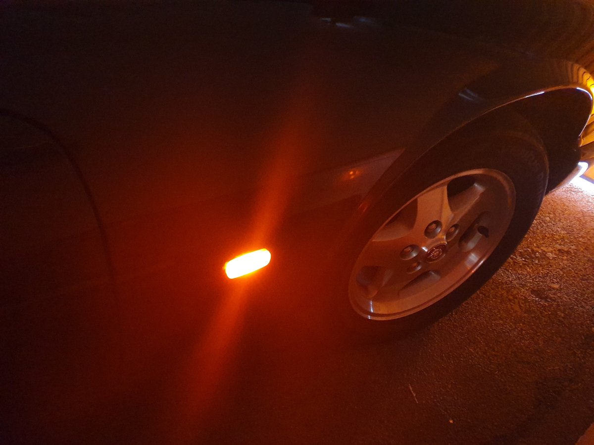

So I thought Id give it a go and see what it looks like...….
Front
Side repeaters
Your thoughts...….
Front
Side repeaters
Your thoughts...….

I'm a fan of originality but they don't look out of place.

Re: Clear Lenses
So having fitted the clear lenses the side reflectors then stood out.....so have 'hidden' them a little.....
Still undecided if its ok or not....but it can all be put back to original easily!

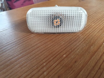

What bulbs did you use in the side indicators? I purchased some 25 SMD amber LEDs but because they sit quite close to the inside of the lens, I think they'll spoil the clear look.
So I've bought some different ones also advertised as "Amber", but I think they'll be too yellow / white, when I power them up?
Also, what did you use to darken the side reflectors? I still have my daughter's old paint box to hand!

Re: Clear Lenses
The bulbs I used are Osram silver coated amber bulbs on Amazon.....chrome indicator sidelight bulbs......
As for the reflector, I used some sticky window tint 35%.(ebay) Cut a template and then stick to the lens...….its a bit fiddly but can be removed if you want to go back to standard!

So, part one is completed. Clear side lenses and some amber 501 LED bulbs that appear completely clear when not in use, but flash amber brightly.
Part 2, the front indicators is also in train but is causing a few issues....
