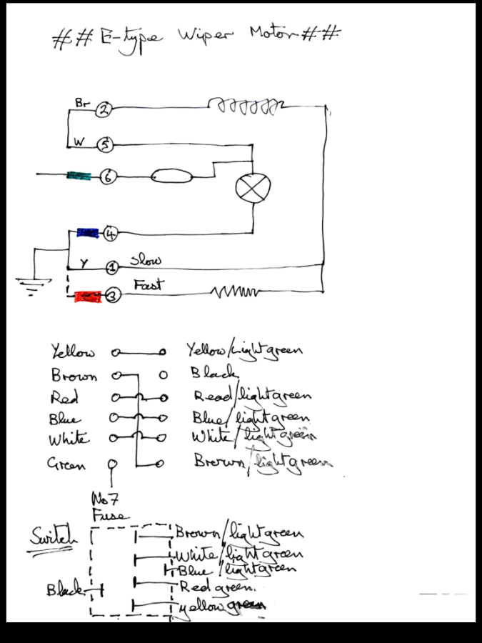

I have stripped down the motor and subsequently decided to get it refurbished. I have obtained a circuit diagram and have been able to bench test the motor to prove it out before fitting in the car. This is worth doing to ensure that all is working before final fit

I have obtained a circuit diagram for the operation of the windscreen wiper motor which can be used for bench testing the motor without needing to take the switch out of the car.
Connect the brown and white leads together, connect the green to a positive battery terminal.
Slow running: connect the blue, yellow and black leads together and connect to the negative terminal of the battery, the red lead is not used Fast running: connect the blue, red and black leads together and connect them to the negative terminal of a battery, the yellow lead is not used
