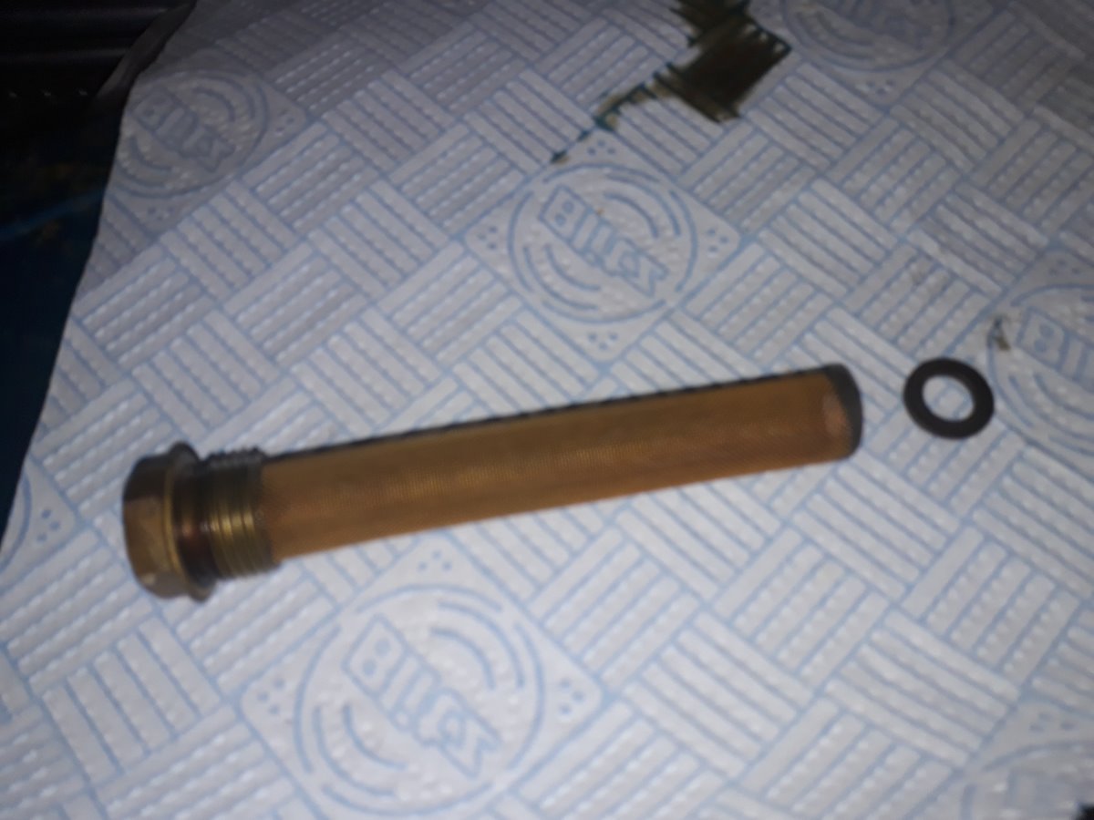

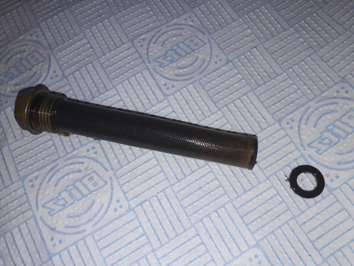

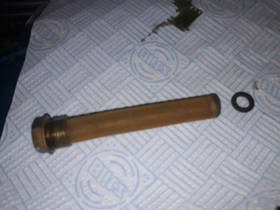

I would think you could remove the overdrive , with engine and gearbox in place , as it just bolts on the back of the gearbox , so no big engine and box out job if it's found not to work , worth cleaning the filter , they get very dirty !
