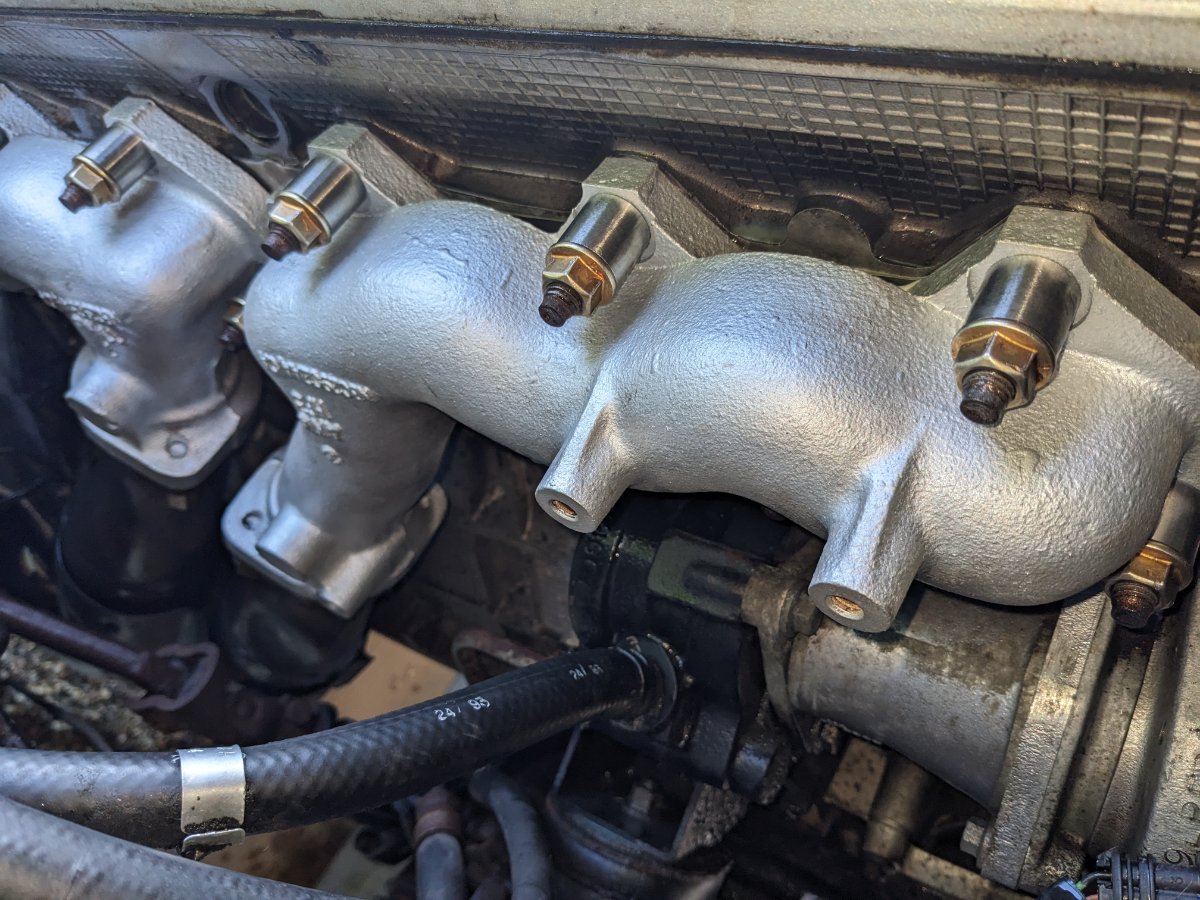

I have replaced both exhaust manifolds with good used items sourced from ebay. I painted them and re-fitted with new gaskets, donuts, extended brass downpipe fixing screws, new bolts etc and all looks good (heat shield also cleaned up and ready to fit).
But it has not solved the intermittent and random hesitation/misfire problem.
