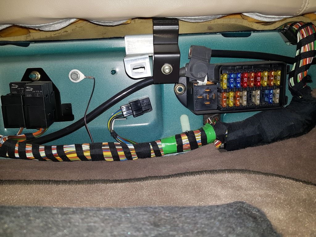

I know there is an auxiliary power supply on the XK8 behind the glove box but does anyone know if there is one located on the XJ8. I have taken out my glove box on the XJ8 and found that there is none located there.

Hi Doug,
It could be behind the RH Heelboard.

Re: Auxiliary Power
Hi Andy, yes there is certainly a fuse board behind both heel boards of the rear seats, but not sure what ones are an auxiliary ones. Do you know?
Re: Auxiliary Power
Hi Doug,
It should be a black plug. There might also be one in the boot ahead of the battery.
Information also suggests: 1998 wiring diagram states "RH heelboard", 2001 states "RH A post".

Re: Auxiliary Power
Hi Andy, Took a look and yes this appears to be an auxiliary socket. There are three wires, a black, a green and brown and a purple and brown. Do you know what these represent or does anyone know?
Re: Auxiliary Power
Hi Doug,
Originaly the socket was for an Auxiliary power socket ( Part No: C2A1403 ) which plugged into the socket you have found.

I would test the wires with a multi-meter and see what you have.
Test with the ignition key in various positions.

Re: Auxiliary Power
Hi Doug,have some more info on the Accessory Socket.
Heelboard fuses:(No 17 is for Accessory)

Re: Auxiliary Power
I have now found that the Green & Brown wire is live at all times. The Purple & Brown has no current whatsoever, regardless whether the ignition is on or off and i have to assume that the Black wire is negative. I have also discovered that both my inner boot lid lamps are not working (bulbs checked, all ok) as well as the glove box lamp. I think it may be a fuse, but i have tried to find a wiring diagram for the various fuses boards within the XJ8 but have failed. Is there a electrical manual available for this car?
