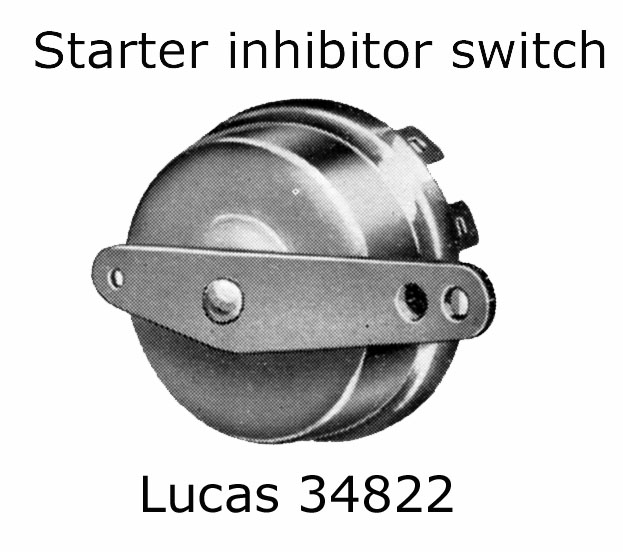

Just bought the 420 with Borg Warner model 8 auto gearbox, inhibitor switch is faulty and unable to source a replacement, tried all the usual suspects: Manners, Barrett, about 8 others and trawled Beaulieu yesterday, with no success. Lucas part no was 34822.[img][img][img][/img][/img][/img] Anyone know of a 420 being broken or any other suggestions would be most welcome. Denis, Waterlooville, Hampshire.
UPDATE 10 Sep 2015:
Pretty well exhausted all avenues to find a gearbox inhibitor switch C23291(Lucas 34822) but have located a C22948 (Lucas 34774), said to be from an S type. It looks similar but with a different lever arm. I am wondering if the switch part would be compatible and whether I could replace the lever arm from my old switch?? Any ideas??

hi any one who might be still interested in this topic. having swapped my inhibitor switch for faulty but not broken one
I stripped the old one. carefully bend back the tags and apart it comes. full of dust etc. cleaned off all the copper runs with WD40 and
a blunt screwdriver.checked with a meter on rotation for continuity of reverse light and no start. yipie found it.on the rotor to go on contacts etc there are 2 spring loaded balls. very very gently use extra fine wet and dry rotate the balls and repeat many times.eventually they come clean and will conduct as required.also crap design the rotor relies on a s**t rivet to pivot on, on the base plate (which is very flimsy)
so i used a scrap piece of panel thick metal between bottom of rotor and base then re-peaned the rivet gently. low and behold it pulled it all tight and the BALLS now make contact when they should. good luck its worth a try.
