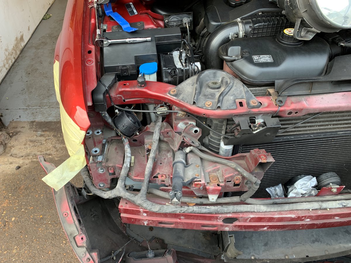

Re: Anti theft alarm horn (battery back-up)
Finally done it!
With the help of a local independent garage!
Had to remove front bumper, O/S headlamp assembly, and crossmember.
