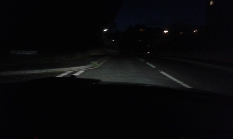

I can only speak from my experience with an OE halogen equipped 2002 S-type with H7 lamps and my current X350R with OE Osram standard HID lamps.
In the S-type I replaced the standard dipped beam halogen lamps with the Extreme Brilliance +130% lamps sold by Halfords. Phillips also offer similar uprates as do Osram with the hologen Night Breaker series. The Halfords units made a huge difference to night time driving.
With the 350, I replaced the standard OE Osram HID dipped beam lamps with Osram Night Breaker HID +130% units. The improvement was astonishing as shown in these before and after shots. Sorry, I didn`t take any images when I changed the S-type lamps.
X350 with Osram HID OE lamps before the uprate. X350 with Osram HID Night Breaker lamps after the uprate. As like as chalk and cheese. Uprated halogens ex Halfords are about £30 a pair. The uprated HID Night Breaker HID lamps were sourced from the internet at around £80 a pair.
Hope that helps.
