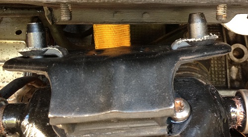

Does anybody by any chance know where I have gone wrong this time? I have the rear legs of the subframe bolted on and all was going well then when I raised the front to bolt the vee mounts in they are too far forward. Do I just need to lever it back somehow (although I don't think that would be easy) or has it got something to do with the way I pressed the subframe bushes in. I studied the photos I took of the old bushes as they are not centrally 'holed' and thought I had it about right. Here are a couple of pics so you can see what I am talking about. I am hoping I don't have to drag it off the car again and re-bush :? Here are a couple of pics so you know what I am talking about.
P.S. it is too far forward the other side but not by quite so much if that helps and I presume there is no particular orientation to the vee mounts

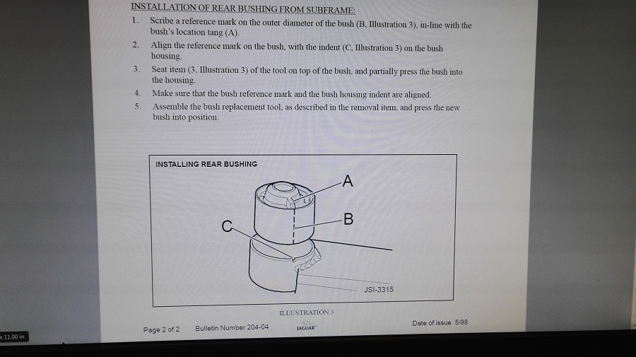

Hi Tim,it does sound like the bushes are not quite right.
I know this is from the xj8 but I'm told they are very similar as are the ones in the xj40,are there any markings on yours like the one in the photo.
If you would like the whole document,P.M. me your email address and I will be more than happy to send them to you.

Cheers Andy and for sending the whole document too. The bush for the x300/40 is a bit different from the x308 so the indent (3) is the same on the housing but I am not sure what I should have lined up with this on the bush. below is a pic of the correct bush for the x300 and I have added an arrow to a possible 'location tang (A)'. Do you think this is the correct way to line up this bush?

If it was me I would line up the location tang on the bush with the indentation on the housing.
The only reference to it that I can find is that they say mark the housing with a center punch in line with the tang before pressing out.
Before you press them out again can you see if the bush was lined up with mark would it make the cross member further back or forward depending on which way it needs to go.

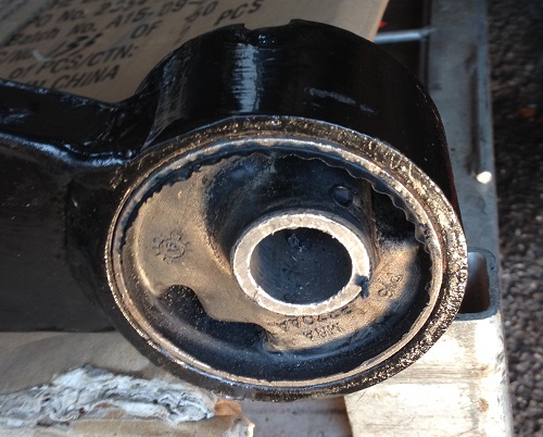

Well I am no further on with this except to say the subframe is back in the garage :cry: Here are pics of the cutouts in the bush housing but I don't see how they can be used to line anything up as the they are at the bottom on the offside and the top on the nearside.
Here is a pic showing the vee mount raised in place with the bush hole not lined up.

I have tried wriggle room and also vee mount in first then bush. It seems to me that if you have pressed them in wrong then you are stuffed no matter what you do. So back to my question; how you do line up the bushes in the first place so that the distance between the vee mount spigots and the bush hole is the correct distance apart? Why on earth did Jaguar not just put the hole in the middle?? The XJ8 has clear line up markings so what do those of us with x300's or XJ40's do?

Looking at the position of your bush (!) I would say that you have pressed them in at 2 O'clock (imaginary line from centre of bush through centre of offset mounting hole). They should be at 1 o'clock, viewed from the outside.
