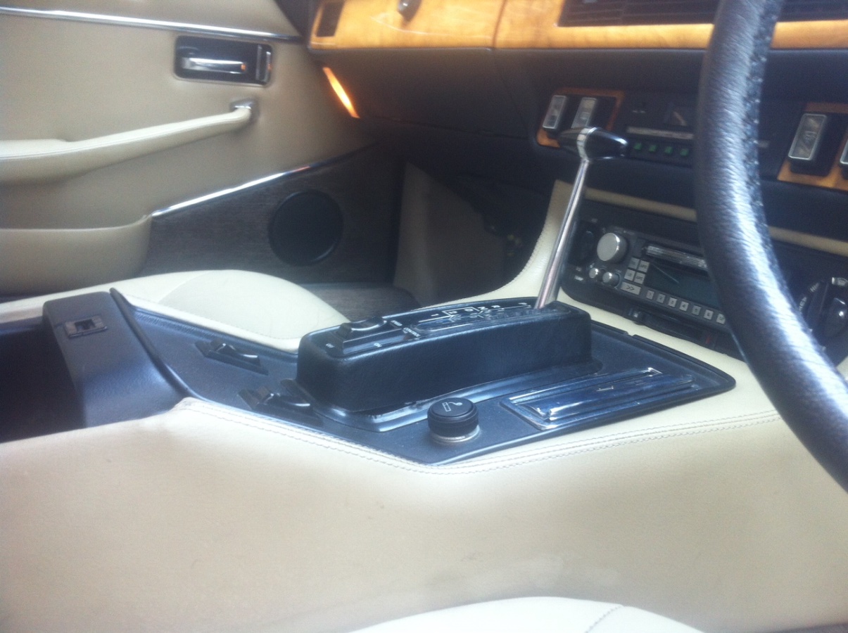

My 1983 HE has got an irritating problem. I've only had the car a few days but I have noticed that the housing that surrounds the base of the auto selector "T" bar is not fitted properly. See photos below:
Has anybody come across this before? The housing seems to be sitting solidly enough, it's not wobbly or anything but it is clearly not right as I hope you can see in the photos. I'm not too keen on taking things apart but would appreciate any advice as to how to tackle this problem.

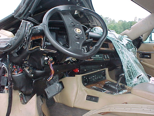

1820 by MyPix on Talk Photography

Cheers BB, more photos...
Brakebuster
Posts:3145
Location:Gloucester UK
Re: Auto transmission selector quadrant problem
Postby Brakebuster » Wed Jun 21, 2017 2:24 pm
better
the good news is that it is the right ski slope , so no need to buy another, however,but there is still a problem ,
I would suggest removing the ski slope, and see if the gear selector mount is in the right place, they are sat on four studs if memory serves, it may have been wrongly put together before somehow,
so your into taking things apart now ,
sorry to mislead you but needed the wider shot to confirm
hope this helps
