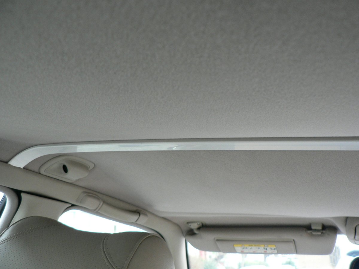

Not wanting to shell out £145 plus £120 for fitting and run the risk of having to fold in the new headlining board to get it into my SWB XJ8 Sport (or shell out for rear window removal) I used a plastic bead from B&Q, bent it in a boiling pan of water, and wedged it between the surround rail either side. My droop was virtually full, from front to back. That was OK. OK until this year's warm weather started again and the heat also caused the plastic bead to droop too
Folding the board, seat and/or window removal isn't necessary for LWB models
