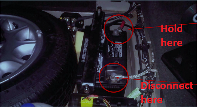

+1 on what Ian has said but before you take everything apart again to check you could try doing a hard reset to see if that puts things back to normal.
By hard reset this means disconnecting the battery and grounding out the positive lead.
This causes all the modules to reset, or reboot if you prefer.
It can clear many odd issues.
It is perfectly safe, provided it is done correctly.
Only disconnect the battery clamp of the ground cable.
DO NOT disconnect the body end of the ground cable.
If I’ve made you nervous, the absolute safest method is to disconnect both leads.
Hold them together for 30 seconds.
Reconnect them.
Nothing can go wrong this way :D .
Hard Reset
Hope that helps and good luck.
Take Care.
Andy :D
