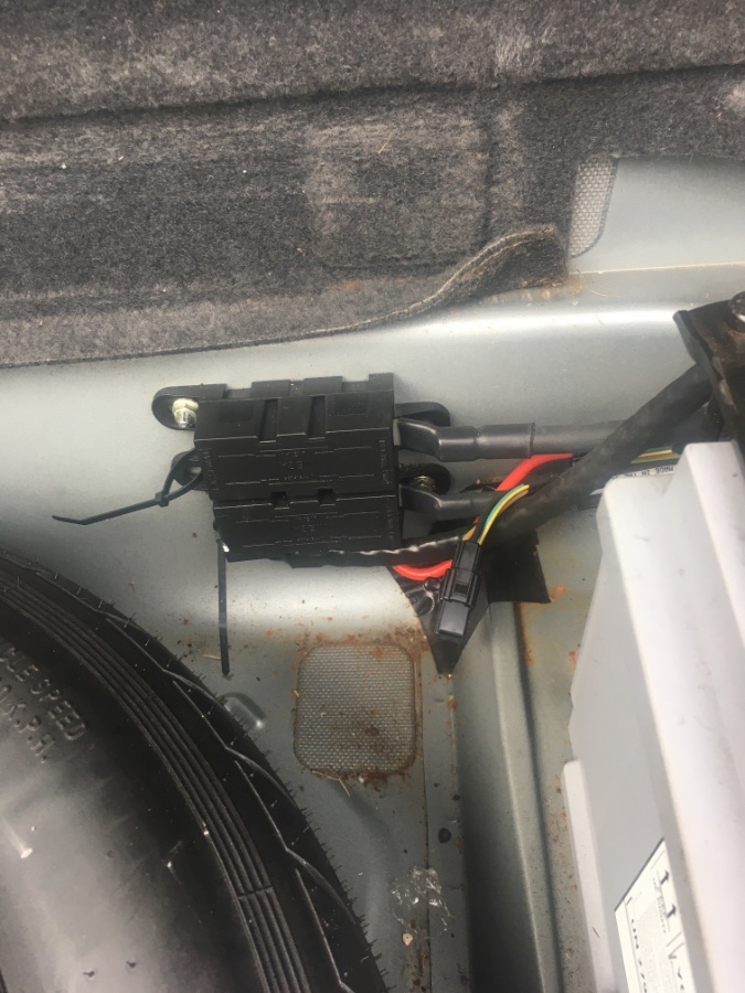

Re: HANDS FREE
This is in the boot just in front of the spare wheel don’t know what it is
Re: HANDS FREE
I don't know but there's a few hints here:
- It SEEMS to be fed directly from the rearmost of the battery terminals
- it has what seems to be two flat-blade, thick-gauge connections exiting from the side.
So, my guess would be it's a distribution point for either main positive or negative battery feeds, perhaps to the front bulkhead terminal points?
Don't think it's anything at all to do with the telephone circuitry in the car.

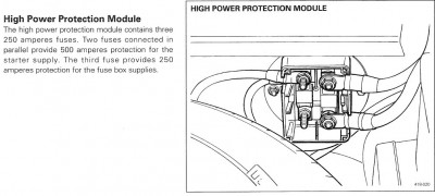

Re: HANDS FREE
That is the High Power Protection Module.This is in the boot just in front of the spare wheel don’t know what it is
The high power protection module contains three 250
amperes fuses. Two fuses connected in parallel provide
500 amperes protection for the starter supply. The third
fuse provides 250 amperes protection for the fuse box
supplies.
Power Distribution Cables.
Heavy duty power distribution cables connect the battery
to the body and the high power protection module,
and the high power protection module to the engine
starter and the vehicle fuse boxes.
Take care.
