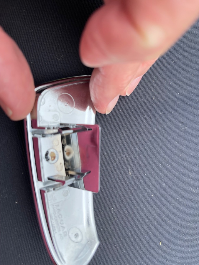

The sleeve holding the chromed plastic lever has snapped. I’ve found the replacement part at SNG but removing the broken sleeve is a bit of a problem. Has anybody found a swift solution?

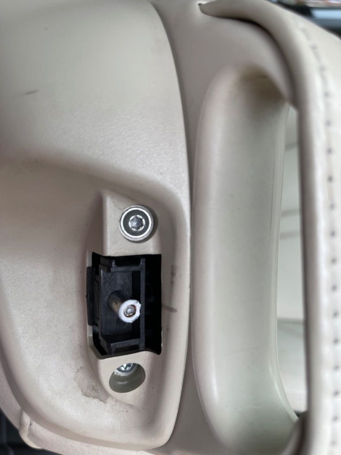

The chromed lever is only held by a single screw which you should be able to access by pivoting the piece to which it attaches. Mike.

O I C. I hadn’t realised it was a screw. I thought it was a permanently attached spindle. I’ve managed to get most of the broken sleeve off. It appears to have been glued.

Again, many thanks Mike. I’ve now pretty much bared the screw and am awaiting the part (due today).

Job done.

Excellent! I was mildly concerned in case the pivot part had become damaged because that is not available as a spare part. Mike.
