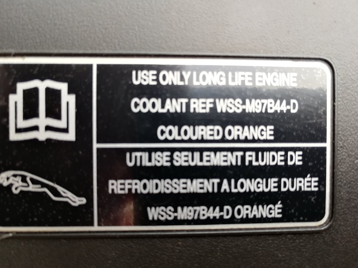

Hi fungus221.
I have a sticker by the coolant reservoir with the coolant type on it.
Not sure if the XK8 has one.

Postby fungus221 » Sun Nov 20, 2022 3:24 pm
Yes I have the same. So that's what I got, I thought.
Suppose you could say the coolant in my XK8 is orange.. I'll have to find some one with pink coolant to compare. But the yellow stuff just seems odd.

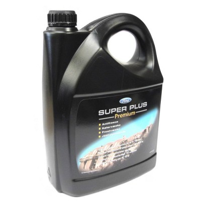

Hi fungus221,
The WSS-M97B44-D number relates to the Ford coolant they used which is an OAT coolant.
So any coolant which meets OAT specs should be ok.
This is the coolant I use.
WSS-M97B44-D
I have used this for several years now with no problems.
Hope that helps.
