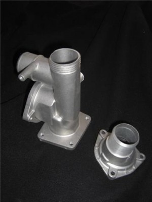

I`ve previously removed the top thermostat tower nozzle and the thermostat. That should allow a drain down via the lowest point. Removal of the thermostat bypass hose also helps.
