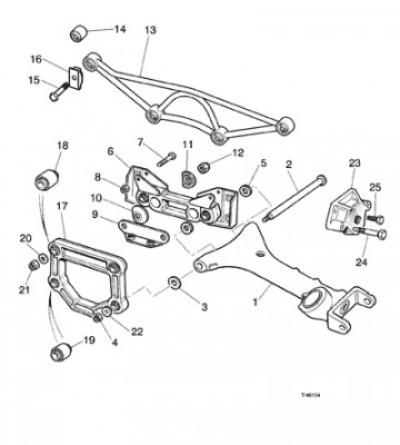

Rob - does this image from Jaguar Classic Parts help? Part number 5 is the washer you gave the part number for.
Re: Rear Wishbone
Hi David.No thanks i have that and the workshop manual but neither shows the way round they go .eg plastic side to bush or metal side to bush.

Very helpfully, the workshop manual says, 'Ensure the correct orientation of the flat sided washers'. However, logic suggests that the plastic washers are probably there to keep water and dirt out of the wishbone bushings so, in the absence of more definitive information, I'd fit them that way around. Mike.
Re: Rear Wishbone
Hi Mike.yes i agree with you and that is the way I've fitted them but the nylon washers just float around and seem to serve no purpose.That is why i am confused,all logic and looking at the remains of the old parts seem to indicate that is the way round but when fitted they just don't look right.
