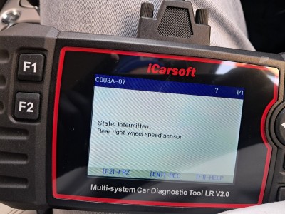

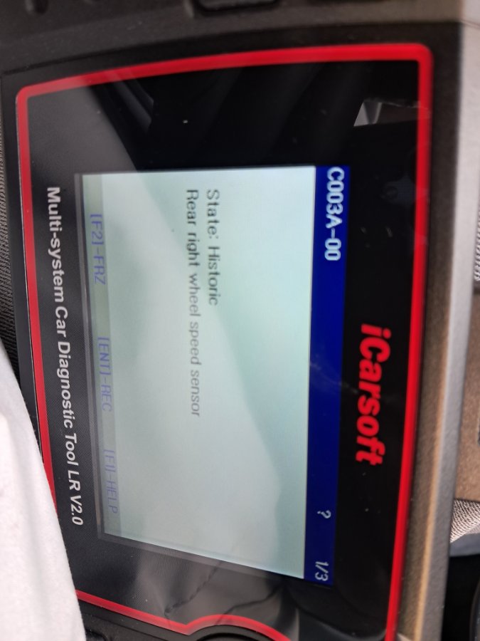

Finally got the fault codes, is this the abs speed sensor and are parts both the same for left and right as will replace both sides to be safe ?
And are these an easy fix
Really appreciate the support
Re: Abs fault / cruise not available
From the diagnostic that seems fairly clear. I would check the cable and the connector before replacing the actual sensor just in case there is a fray or dodgy connection.
Looking at the speed sensor for X100 and X150 they are not radically different. I have experience of X100 and in theory it's a simple job if the one you are replacing hadn't been in there that long. However over time the casting and component seem to glue themselves together! Be prepared to feed penetrating oil to the existing sensor and where it mounts into the casting - keeping the spray away from all brake surfaces - leave to soak overnight to give the best possible chance to extract it whole.
Also the workshop manual has the following guidance:
CAUTION: Make sure that the harness retaining bracket is not removed. Failure to follow this instruction may result in damage to the harness.
NOTE: Note the orientation of the clip.
CAUTION: Note the fitted position of the component prior to removal.
Torque: 6 Nm
NOTE: Make sure that the component is installed to the position noted on removal.
I hope that helps - good luck. Let us know how you get on.
