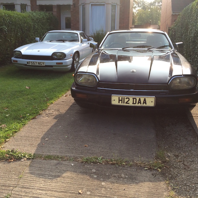

this can be tricky as the spindles may well be in the wrong position on the arms, but assuming they are, the left wiper blade should just touch the screen rubber on the far left when it is parked, and the drivers wiper blade should be at an angle with the end of the blade against the rubber, I think the drivers blade is the shorter of the two
this is how they sit on both mine and Phils car ( 1989 and 1990 )

as a sub note, the drivers arm has a bend at the end where the blade is, and the passengers is straight ,

Thanks, those pictures make a lot of sense.
The shorter arm was indeed on the drivers side, although when I swapped them over the coverage was better but they still don't look quite right. Maybe my blades are the wrong length, are your blades 400mm as well?

I'm getting there! It transpires that the blades should both be 15" so mine are a bit long. I can't remember when they were changed last, I expect it was during an MOT a few years ago so they likely put on whatever they had on the shelf.
New Bosch ones are on order, so when they arrive I will play around with the arms and find the best compromise to get a good fit.

New ones arrived and have been fitted and adjusted. A vast improvement. Thanks to BB for taking the time to help.
15" are not that common it seems, which explains why someone had put 16" ones on.
