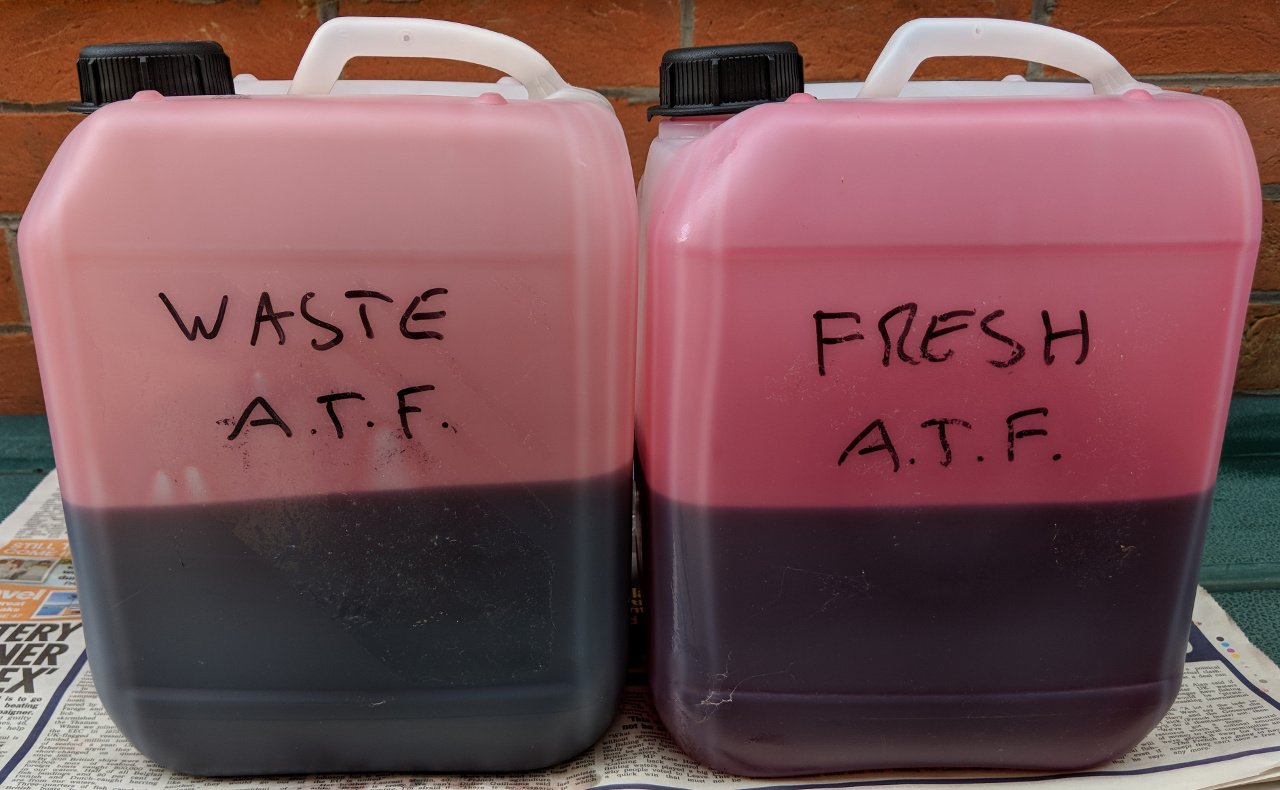

Tris,
The dirty ATF will have about 18% of the original fluid diluted in it. However, it does seem quite dirty, although it's difficult to see in the opaque containers. Could you pour some dirty and clean fluids into clear glasses so we can see the difference?

I will do that for you when I do the next change.

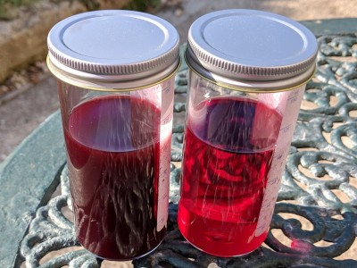

Ok, here's the result of change 7...Tris,

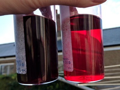

Tris,
Now it's in the clear glasses, I don't think that looks that bad. It only takes a small amount of dirty oil to change the colour of clean oil.
