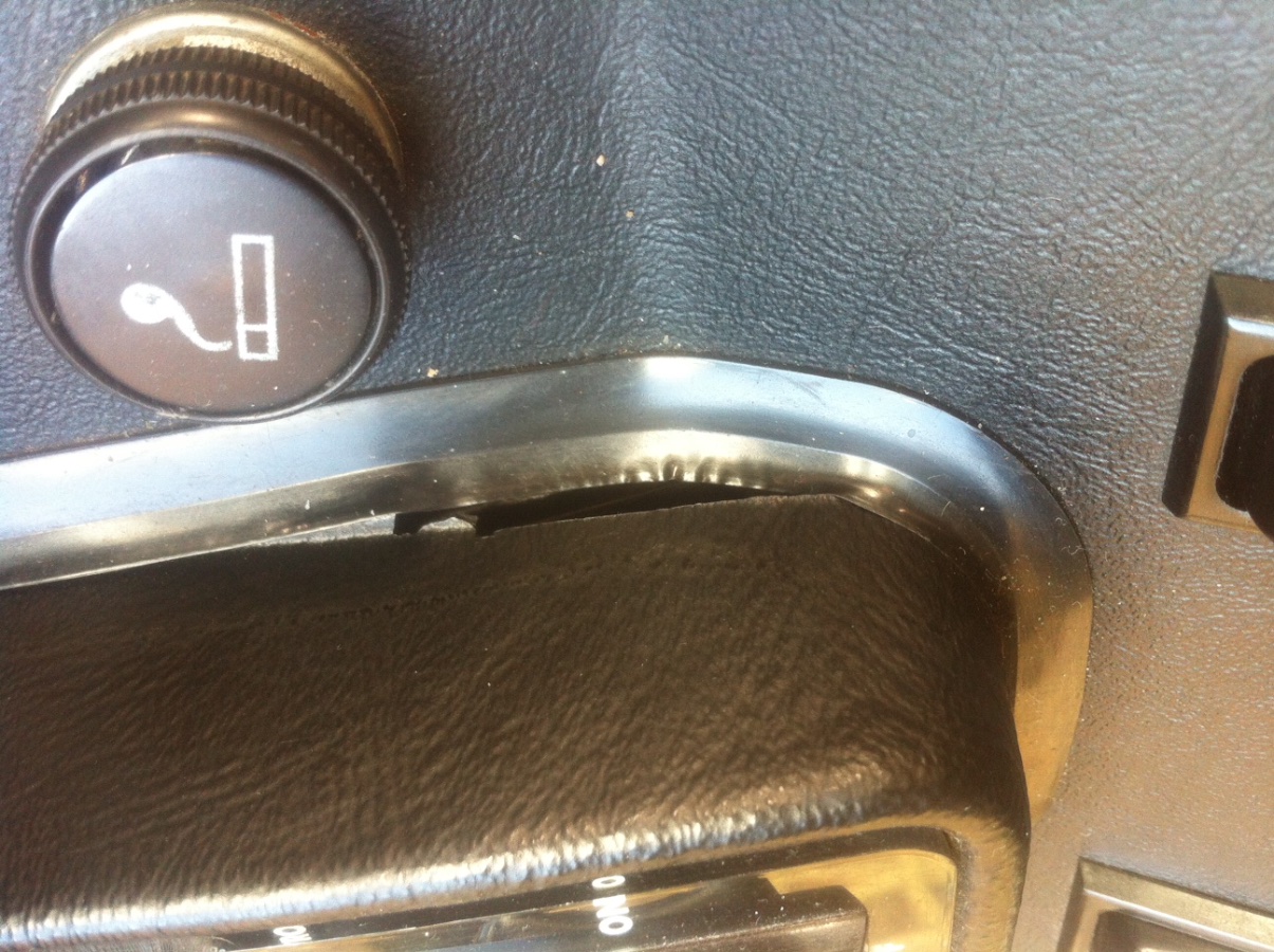

My 1983 HE has got an irritating problem. I've only had the car a few days but I have noticed that the housing that surrounds the base of the auto selector "T" bar is not fitted properly. See photos below:
Has anybody come across this before? The housing seems to be sitting solidly enough, it's not wobbly or anything but it is clearly not right as I hope you can see in the photos. I'm not too keen on taking things apart but would appreciate any advice as to how to tackle this problem.

i'm afraid you have the wrong ' ski-slope ' fitted to that car
i expect the PO replaced it certain parts due to being cracked and damaged, and to sell the car fitted one from an earlier car with a different profile to the ski-slope
luckily these can be sourced fairly easily depending on you budget
try and get one to match the existing wood in its current faded condition ( they all fade over time ) , as a nice brand new one which will also be more expensive will be a lot darker in finish

Oh dear. Yes that explains it but has left me rather disappointed. One of the reasons I bought the car was because it had the older black ski slope which I like. Unfortunately I did not know that there was a different profile to the ski slopes. Would I be right in thinking then that the correct ski slope profile would not have had a black finish in my car? The car btw was registered 1/1/84 so must have been manufactured sometime in 1983.

yes, you can get the 'HE ' ski slope with black vinyl covering ,
there were three versions ( not allowing for different shifter options )
original version like the XJ6 saloon ( like has been fitted to yours i think ) , the ' HE ' with less of an angle in the ski slope and different cutouts for cigar lighter and cruise switch , and the later ' Facelift ' versions, almost the same as the HE , but made differently
the good news for you is that you can get the correct version and cover with new black vinyl yourself, and would be very easy
where about are you ? i may have a spare wooden veneer one that needs refurbishment, so can be covered in vinyl ( or leather for that touch of class )
also , can you put up a wider shot of the ski slope and up the right way for me to confirm the is the problem
BB

i still need to see a wider shot of the console with the ski slope just to confirm that the right one is to be obtained, as the leather console changed shape, hence the change of ski slope

the good news is that it is the right ski slope , so no need to buy another, however,but there is still a problem ,
I would suggest removing the ski slope, and see if the gear selector mount is in the right place, they are sat on four studs if memory serves, it may have been wrongly put together before somehow,
so your into taking things apart now ,
sorry to mislead you but needed the wider shot to confirm

Well, I set to with the screwdriver and it was indeed as simple as BB said. Thanks again for the support/advice. Unfortunately apart from a small crack in the plastic the quadrant seems to be sitting exactly where it is supposed to. The two metal plates that support it are firmly bolted down in their place. The quadrant is sitting solidly on those plates. The fact of the matter is it is just not lining up exactly as it should and it looks like theres nothing I can do about it. I can't believe it came out of the factory like that but maybe it has moved a few mm over the years. I don't know but it is what it is I suppose.
