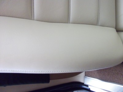

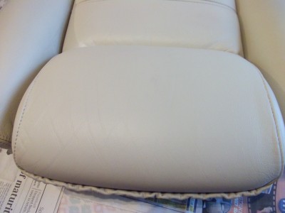

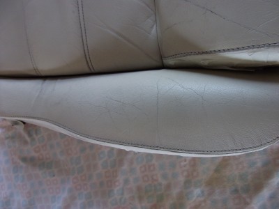

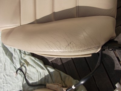

David,
I would politely suggest that unless your stitching has disintegrated or the seat foams have collapsed, then it's perfectly feasible for you to refurbish those seats and armrest using Furniture Clinic products.
The wear on your drivers seat is really quite typical of late XJS wear and shows up worse on the cream-type colours.
I recently redid the drivers seat on my car which had some wear in similar places. See pics of after & before.
I would recommend that you buy the basic kit and also some flexible filler and some leather binder. As regards finish, I would use Gloss, followed by some Gloss diluted with Matt. You might need to experiment to get the precise finish you require. The most fiddly part was using cocktail sticks to laboriously poke every stitch hole after each coat to avoid that over-painted look that cheap recoloring can give.
Many of us have had really good results using the FC products. The modern products really do give a very cost-effective alternative to £2000 worth of new seat covers. And even if you do ultimately end up needing new seats, the £50 you'll have spent will still be money well spent and really good practice for future seat refurbishment.
Worth a try IMO.
Good luck
Worth a try IMO.
Good luck

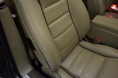

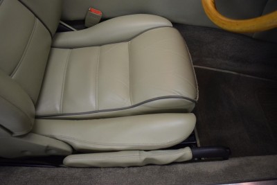

Hi David
I concur with Pauls points re stitching padding and the general approach of refinishing over new leather but would add a couple of points.
You will need to mask up the piping before spraying the general leather. Even so, you will get some overspray on the piping which will then need re-colouring. The piping is vinyl, not leather and needs a different prep solution and you will need to colour it using a fine artists brush with the appropriate colour. After the piping the whole seat can be sealed.
I would use gloss then satin sealant rather than thinned gloss.
Set the seat back rake to a suitable position for the work using the motor before removing the seat, as you can't adjust it once the seat is disconnected and on the bench - obvious, but annoying when you forget!
Have a chat with the guys at FC - they are really helpful and knowledgeable.

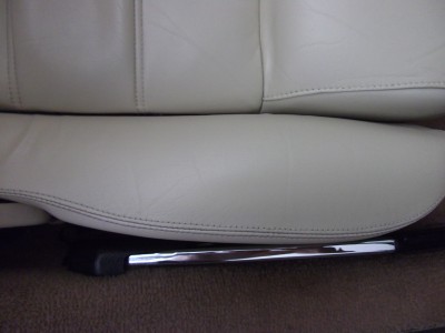

I have no before photos of mine but attach some of the "afters".
Good luck.
Robbie
Good luck.
Robbie
