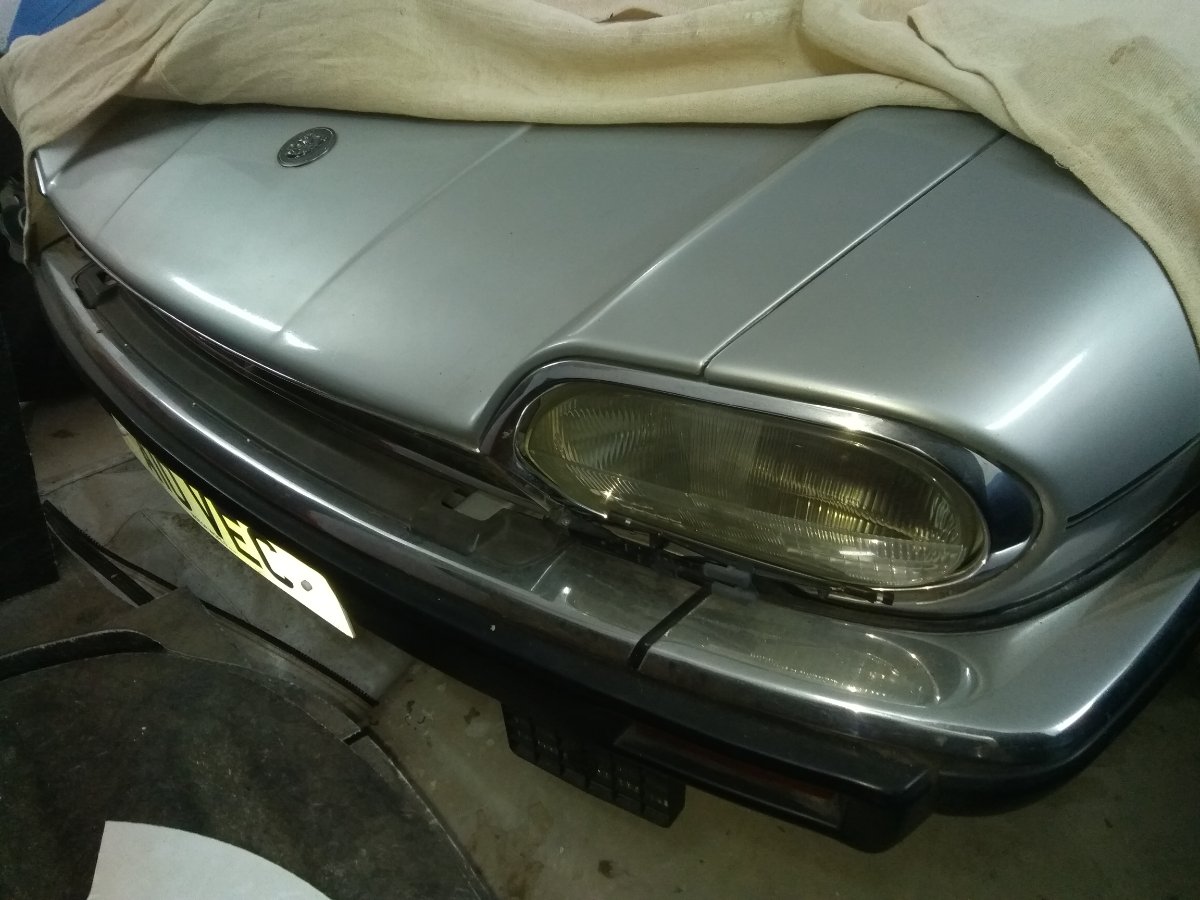

A10 (Silver)

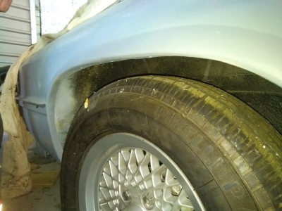

A10 (silver)

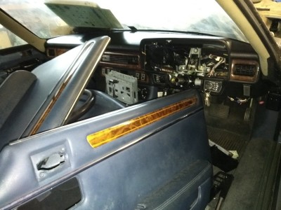

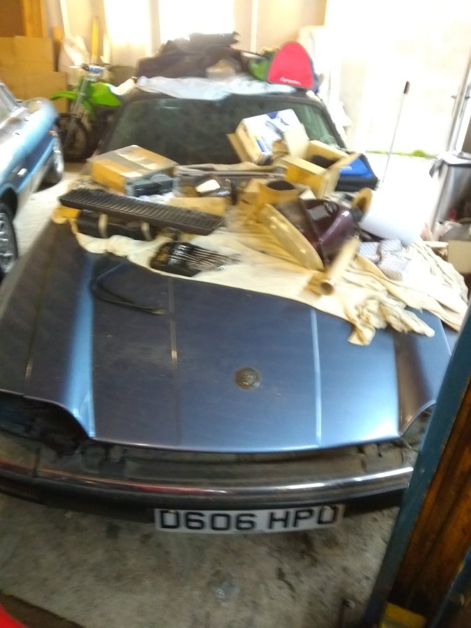

D606 (blue)
Please excuse the car parts all over it and my terribly blurry images. This is the one that's partly disassembled (interior, headlamp section).
