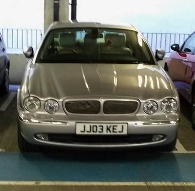

Not a happy bunny at all at the moment. I put the car into the garage for 4 wheel alignment (made a big difference to the way the car feels, much more positive now) but whilst the car was with them the nsf wing gained a 2 inch long gouge from the headlamp back.
It's cut into the alloy of the wing to a depth of a couple of millimetres...to say I am pi55ed off is an understatement. The garage have accepted full liability and will organise the repair...but it still doesn't help my mood :cry:
I've now worked out how to resize the pictures so here are a few of the car in my ownership:-
XJR 1.jpg (68.53KiB)Viewed 5366 times
xjr 10.jpg (51.95KiB)Viewed 5366 times
xjr 8.jpg (56.74KiB)Viewed 5366 times
