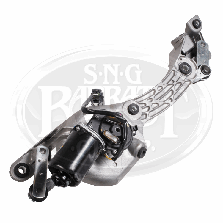

Mike i have been looking on the SNG barratt website and they show the full wiper assembly if you look closely the wiring feeds the motor and two items covered or capped by what looks like polyurethane covers that seem to sit on a cam arrangement! I think these might be some sort of position sensors or switches, what do you think? I have attached the picture i am looking at.

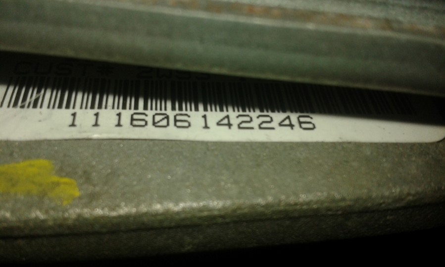

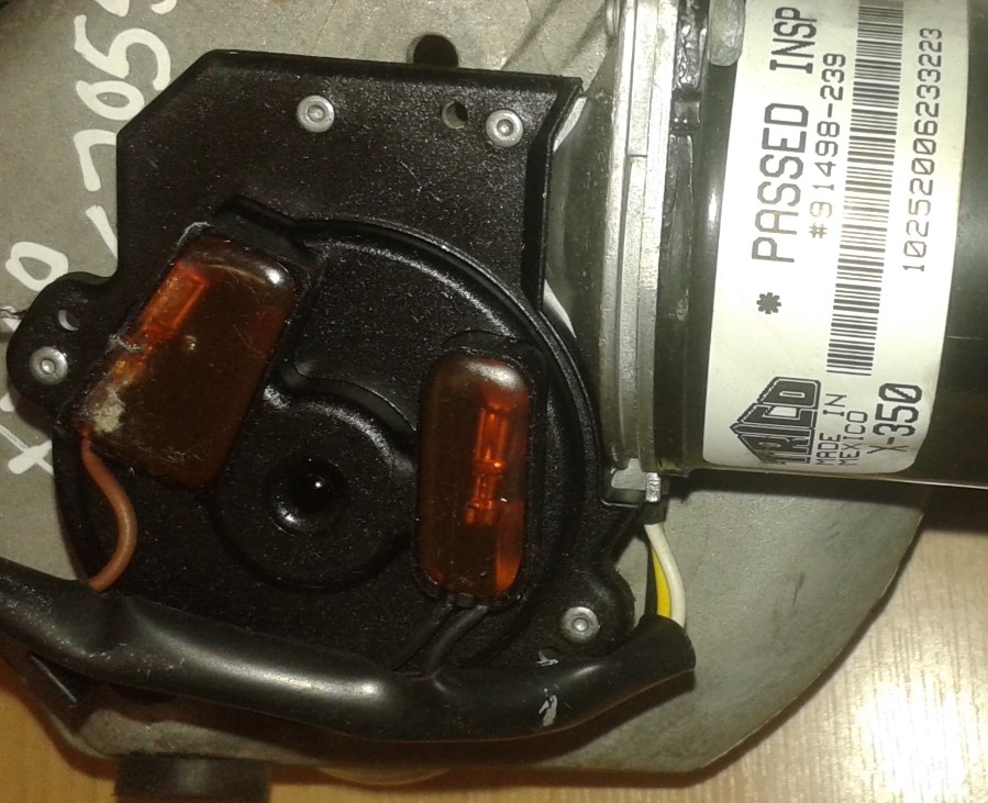

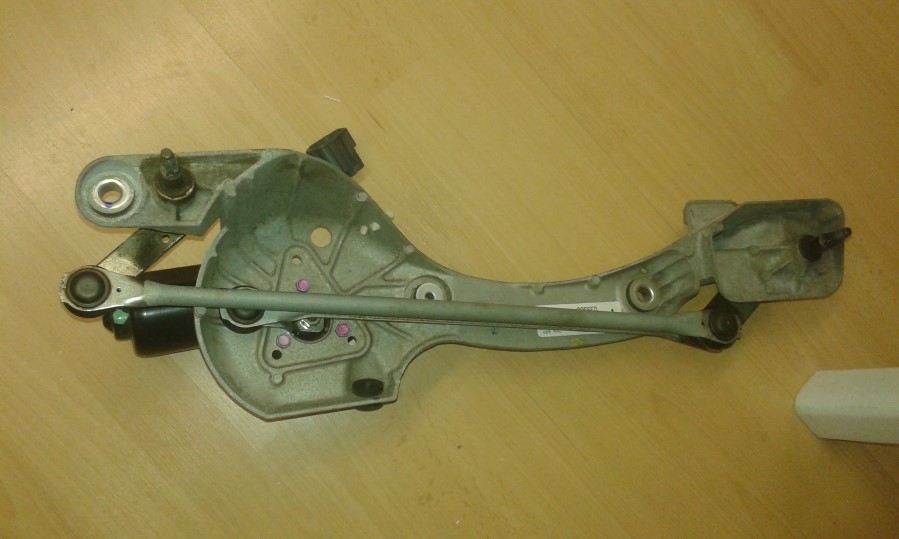

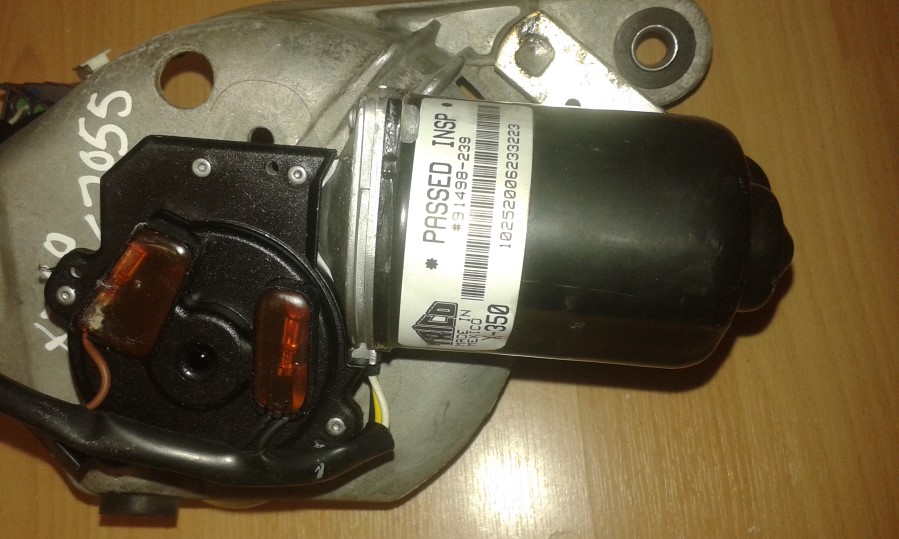

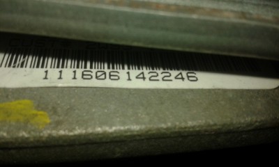

Bang on time, DHL delivered the ex-Eurojag X350 used wiper motor and mounting complete with lever arms and blade spindles arrived this afternoon.
The motor is fixed to the mounting by five small pop rivets. Colour code on the cables from the plug are black, white and yellow direct to the motor and are grommeted through the motor case. A brown wire goes to one of the two sealed cam type switches and disappears into the gear case.The black wire also goes into the other cam case switch and then emerges again as the black cable going to the motor via one of the aforementioned grommets. Two 8mm PZ2 sized cross head machine screws fix the motor to the lower motor case with the switches on the gear cam case. All this is perhaps academic as an internet search does not reveal any spare parts availability.
The complete component is manufactured in Mexico by the Trico Corporation. I`ve tried to source individual spares for this unit from part numbers seen on the assembly.....nothing seems to be available.
This wiper assembly under the visible number on the case is 2W93-17500-BC. However, it is more commonly listed as C2C 34188 which is the more recognizable Jaguar part number. It is NLA on the Jaguar Classic Parts site. As said in my previous post, you might be hard pushed from 19/12/2017 to source a new component and like myself find that you can only find second hand units. Grab a second hand unit as a spare for the future. These units will become impossible to source in future years. My parts search shows current typical prices at between £35 and £50 plus post then plus VAT to be the present going rate for a used unit. Expect postage charges of around £12.50 plus VAT. Eurojag and Autoreserve have a stock of them.
Fitting of this replacement unit and or replacement will take place as soon as I feel enthusiastic....

Mike,
I've been following this thread to see if the solution could bear any comparison to the old X308 wiper problem, but I had not looked at the X350 circuit diagram until today when prompted by your latest findings. As with most electrical X350 problems, complication is the order of the day and it is possible that a faulty wiper motor relay could cause some slight 'overrun' type parking problems. This is because it has a changeover contact which supplies either +12V to the motor, or a ground connection to provide regenerative braking to stop the motor quickly when the wipers are switched to off.
However, I suspect that the majority of parking faults are caused by the park contact. It seems that Jaguar have not learned their lesson from the earlier X308: the Park contact in the wiper motor assembly does not actually control the motor current directly, as with simpler cars of yesteryear. Instead it merely provides a signal to ground at an input on the Front Electronic Module (FEM) when the park position has been reached; the FEM then turns off the drive to the wiper relay and the motor stops immediately. The long term problem appears to be exactly the same as with the X308: there is insufficient current from the FEM input pin to provide a 'wetting current' to keep the park contact clean and free from oxidation. The result is erratic contact resistance which will sometimes work - as you found today - but may not tomorrow.
Cleaning the switch contact(s) may help - I note from your photos the used unit seems to have two - however the circuit diagram only shows one, so if these are wired in series that poses a possibility for even more erratic operation. On the X308 liberal dosing of the switch with WD40 seemed to provide a long-term fix and may do so here, however judging from what you have been saying about access to change the whole assembly for the used one, the X350 motor contact(s) may be inaccessible once in the car.
I think that a modification to increase the wetting current may be possible if a suitable resistor is added from the park contact to +12V. This needs a bit of investigation as to where the wiring harnesses run, but it could go from somewhere along the Black/White wire from the wiper motor unit to a switched +12V such as at the wiper motor relay in the front power distribution fuse box.

What externally shows on the wiper motor unit as possible cam micro switches, are in this case are two solid masses of plastic which visually appear to simply cover or pot two simple cable end crimps from the short motor loom to the central part of the motor unit above the gear case. I assume the micro-switches are below the plate. If my existing unit does eventually have to come out of the car with the second hand Eurojag part being substituted, then that will be the time to demolish the defective unit and see for sure what lives inside. As regards relays, Eurojag sent me a bag of them which was good. Well pleased to have those spares as a new one is £23 plus VAT and I now have eight or nine various units. Good chaps are Eurojag. I did a substitution of the two units showing on the handbook fuse box diagram with no improvement. So I put the original items back in to preserve future diagnostic integrity for Ray next week. In the meantime, the wipers suddenly improved!
