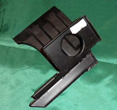

340jag
Posts:165
Re: jacking points
Postby 340jag » Sun Mar 17, 2019 8:30 am
A little diffrent from a MK2 !
Try Jagspares International ,
McBoney
Posts:6
Joined:Fri Mar 15, 2019 4:26 pm
Re: jacking points
Postby McBoney » Sun Mar 17, 2019 1:59 pm
Thanks, I saw that. More than £300 plus VAT! And I only need the tube section for that area, so I will see if I can get that separately from my workshop and see if I can find anyone to weld that on. If not, I'll have to bite the bullet.
Thanks for the link though! :)
