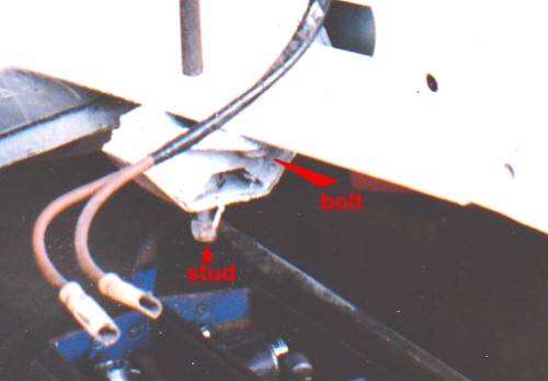

In the coming weeks I will be removing my complete front suspension for refurb which looks pretty straight forward apart from one thing
There is a V shaped mount on either side, how are these connected to the body / which way up are they / are they easy to access. As the car is covered up at the moment and I can't see the area

The rear mounts of the front cross beam (if that's what we're talking about) are attached to the chassis rail by two bolts and to the cross member by a stud. If the engine is out, they are quite simple to get at. If it is still in things are a bit more restricted.
I found getting the front mounts off was the biggest challenge: the sleeve inside the rubber bush had rust welded itself to the large bolt.

Exactly what I needed to know, much appreciated almcl
