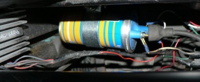

I don`t appear to have a spark, even though new plugs are fitted,can anyone tell me if a suppressor is fitted to the back of the ballist resistor as mine has what looks like one, round and blue in colour and wire is connected to another and they both go to the coil( it may even have no bearing on the issue) , can`t see how it`s fixed as I can`t see a bracket on the back of the ballist resistor I have purchased to fit anything to it. I have power to the ballist resistor but not it seems to the coil on testing, even after rigging up a new one without removal of the old one, so I think we are still looking at the wiring as it does seem quite brittle, and these engines certainly produce some heat when they run.I will be checking all the electrics again this morning for the umpteenth time, just in case I have missed something, thanks for peoples input.I`m determined to resolve the issue and get it running even after I have called it every expletive going, and sporting the odd plaster here and there as others know there is little space to work in this area where the coil etc is housed,Regards Paul

Hi folks, just thought I would give an update on the starting issue I had with the series 2 . I got it towed to the usual garage I use for the modern vehicles if we have an issue just hoping they may be able to do something with the car( they have never worked on it as I haven`t had a problem that`s not been fairly simple to rectify)They changed all the following which I supplied that came from SNG Barratt or David manners Group, coil, ballast resistor (plugs and ignition leads I had changed) distributor cap, rotar arm and it still refused to start.They traced the issue to the illuminition ignition system.So I ordered a new one and they fitted it and we are running and we have her home, thank goodness.I am now waiting for a low pressure power steering hose to be delivered which has split and it will return to be fitted and hopefully we will be ready for the season ahead, although it will miss Drive it Day on the 28th April were up and running that`s the main thing, Regards Paul

I too have the Luminition system on my series 1, 4.2L lump. But had an awful fault that defeated two "standard" motor mechanics -- start, die, start, die... By the time I'd bought the car the carbs had been seriously mis-adjusted in some previous owner's attemps to fix. Luminition system gives a switched LT.
Eventually, a change of coil fixed as the internal ballast resistor had gone intermittent. It was breaking down once the HT had been generated inside the coil due to faulty internal insulation and faulty windings. Changing coil to one without ballast resistor would work but it's better to get a "proper" equivalent which is what my shop did supply. I've got the docs for Luminition system that was fitted to mine in the mid-80s if you need.
