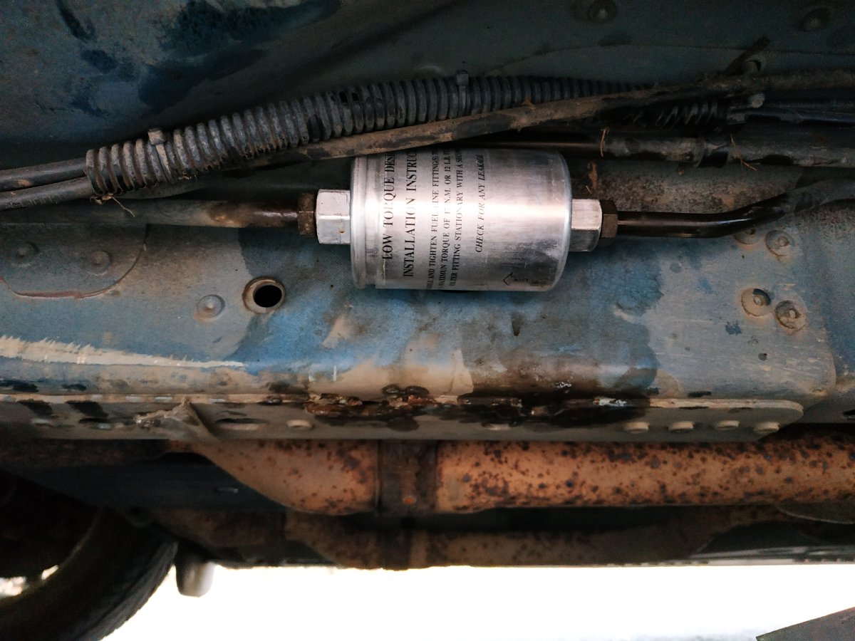

Re: Fuel Filter
Postby J44EAG » Tue Apr 30, 2019 10:22 pm
To confirm, on a V8, the fuel filter is up under the centre tray, near side, approximately on an extended line down from the front of the passenger door/rear of front wing shut line, inboard of the sill cover. Removal of the tray section is desirable but corrosion of the captive nuts inside the long chassis leg often prevents easy fixing removal. The captive nuts can spin inside the chassis leg. That is a real nause as it prevents the section of tray dropping down to gain access to the filter.
If the filter has not previously been changed, then I`d advise getting the car up high enough to tackle the fixings issue. Changing the filter is easy compared to getting these sections of under-tray removed!
