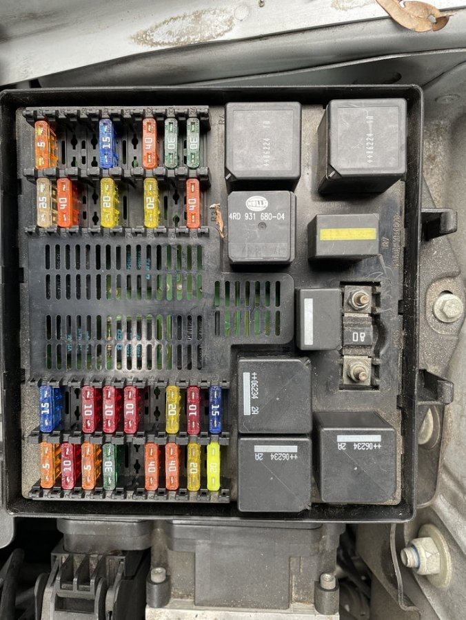

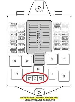

You can power up the car from the fuse box under the bonnet. Put the + lead of the power supply on either one of the metal terminals of the 80 amp Fuse No 35 and the other one to any good earth.
Only do this to gain access to the boot,not to charge the battery.
Engine Compartment Fuse Box
Fuse No 35 Circled In Red
Front Fuse Box.jpg (22.51KiB)Viewed 2051 times
Hope this helps you.
