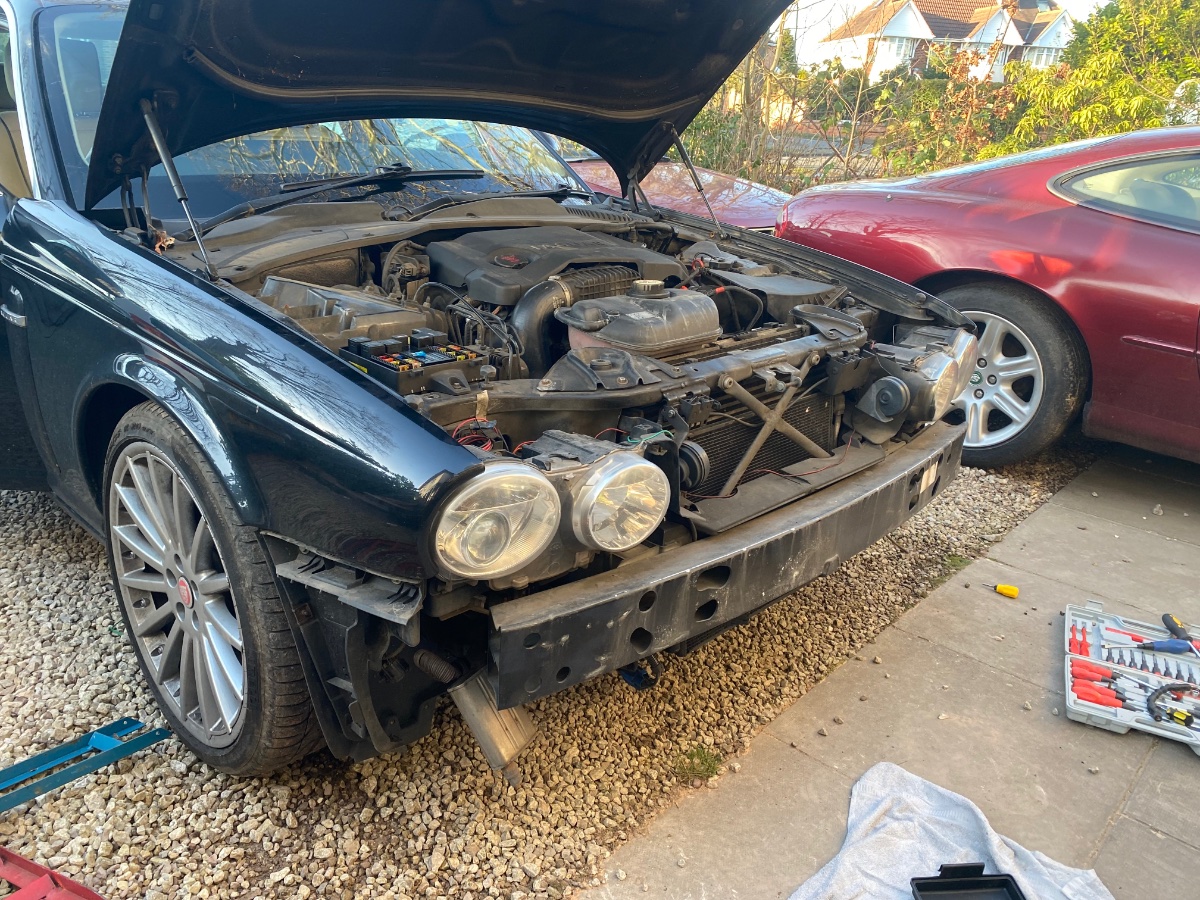

Hi so my electric woes continue f9 fuse blows as soon as it’s inserted it’s for the mafs, cooling fans , glow plugs ..
I disconnected the mafs fuse still blows . I’m trying to disconnect the fans but not sure which visible connection I should pull . There’s a short somewhere ..

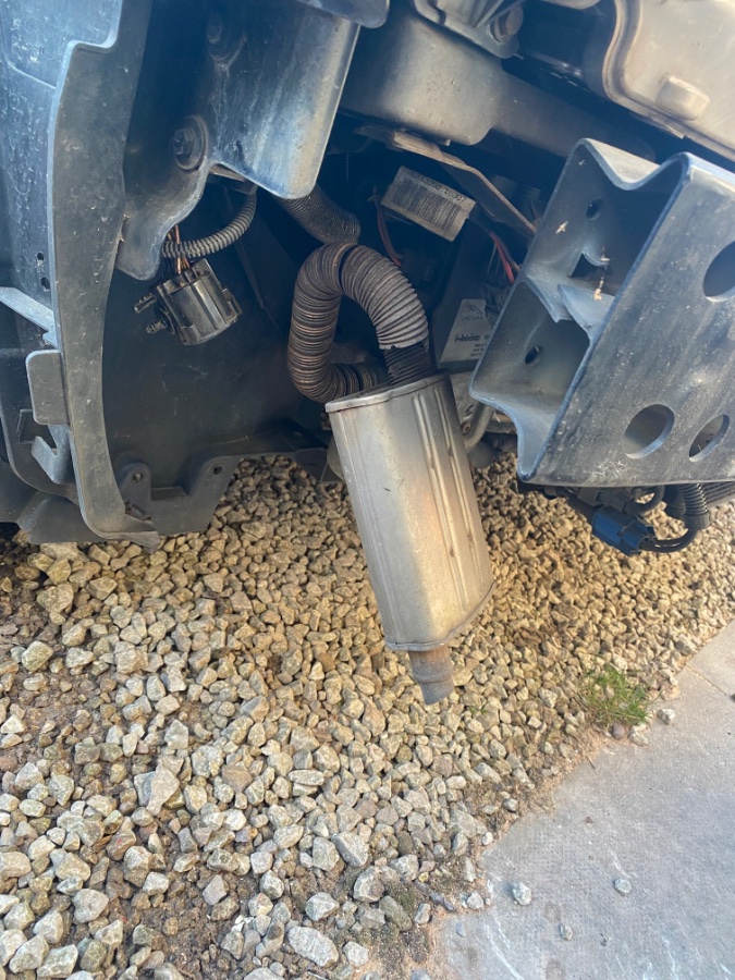

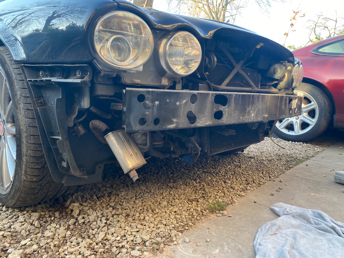

So in the moment of madness Iv taken bumper off as the front muffler was leaking smoke through the headlight and the whole pipe is croded.. any way any help with which plug to pull to isolate the fans
