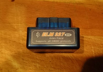

To diagnose, you really either need to get a garage with IDS dealer level diagnostic gear or stump up for the iCarsoft 930i diagnostic tool at around £100. I see they have just bought out a later unit known as a LR11. That has more functions and is worth investigation. That seems priced at around £140 which is similar to the appropriate Foxwell tools which a couple of guys here operate.
Rather cheaper and well worth getting is an ELM327 V1.5 blue tooth chip from ebay. The cost is about £6. That works with a Torque Pro download app for about £20 and uses an Iphone or an Android phone. PTJS1 and I set up Lambda ossilographs on my Android and that showed us I had flat lining NSR sensor gone duff. Cheap and cheerful as it is, the ELM327 and other parts work quite well.
All units show fault codes and have a code clearance facility. I won`t travel without one. My ELM unit stays almost permanently in the OBD port. That makes for quick linking to my Android phone and can help me clear a PO430 fault code which can sometimes occur if I`m over enthusiastic with my methanol injection system on a cold day. The brew can cause a catalytic converter to catch a chill during winter months!

Very hard to say, Sam without the car linked to diagnostic gear. Gut feeling ....perhaps a coil or plug gone down.
The ELM units are really only suitable for Android or Iphone. It sounds as if you have some kind of connectivity issue. Presumably you have the phone blue tooth working on your phone...I suppose you must have. You do need to get the Torque Pro download app to make it all function.
If you don`t mind forking out about £100, then the iCarsoft 930i or the latest LR11 is a bulletproof way to progress. Nothing like a proper dedicated scanner. Mine has proved its worth on many occasions.
Really sorry I can`t help further with the connectivity issue. Do you have a local bod who is a wizzer with this kind of phone issue?
Let us know how you progress.
