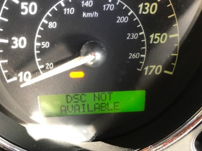

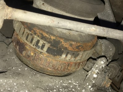

It seems there’s loads of different ways this DSC fault comes on.
Which lead me to find this broken ABS reader ring.
Any thoughts on how best to fix? It looks like the whole shaft might need to come off to change the ring?

Re: DSC Fault & ABS Light
Corrosion on the interface between the joint and the ring bursts the ring off the joint!
I once found replacement rings for the X-type but not for the S-type. I imagine the fix is probably a complete shaft replacement....that can be a nasty job because although the shafts are on splines where they enter the diff, they pick up in service over the miles and the years and can bind up solid when any attempt to extract a shaft is made. I watched the guys at Jagcare in Portsmouth go blue in the face with exasperation as they tried every trick in the book to get a shaft out. Slide hammers, lump hammers etc, etc. Eventually, the shaft came out but not before the guys virtually collapsed with fatigue!
My Indy replaced the Half Shaft, I was told it was the only way.
viewtopic.php?f=194&t=6358
I have since found out it can be done in a workshop and reluctor rings are available, Half Shaft still has to be removed.
http://www.reluctorrings.com/cars/jaguar
Doug.
Doug.
Great info as always. Thanks guys. It can never be simple can it?
Sorry, forgot to say, this is on X350R. I found this thread through a google search, and assumed it was 350 (as that’s what I searched), then noticed it was S-Type after I clicked post. I assume the parts are the same?
There was a blow-by-blow article of that job being done on their project car in Jaguar World earlier this year
Ok thanks.There was a blow-by-blow article of that job being done on their project car in Jaguar World earlier this year
I guess I would have to hunt down back issues to find that article?
