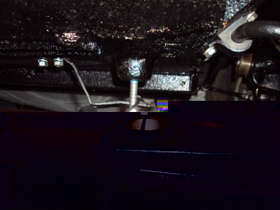

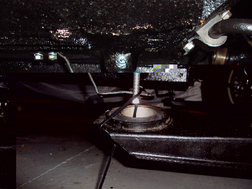

Pat, don't know if your still scanning the forum but I thought I'd upload a photo of radius arm mount problem to see if you think it is a problem.
Thanks

I don't see a problem with the siting of the cup. Before jacking the arm into position I would clean back to bare metal the cup surface and coat in Coppaslip or similar and save yourself or the next owner a pig of a job trying to get it off in 5 years time!
Pat
