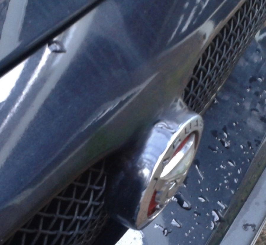

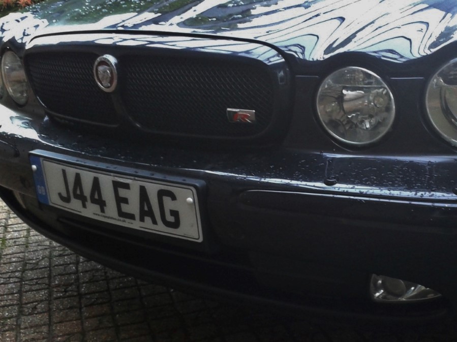

He is my mod on an X350 with 70mm ebay sourced growler badge. It is a bit of a take on the later X358 grill.
The grill on the X350 is glass fibre so machines well. I made a circular plinth from e-glass and epoxy cast inside a Holts spray can lid. Removed from the lid, it was then cut it to profile with a Dremel type unit with a miniature cutting disc.The plinth was then epoxied to the grill surround and blended in with an epoxy/easy sand filler powder. A bit of blending to profile with glass paper gave the basis of the job followed by four coats of primer, a flat down and five coats of matching spray paint. Once dry, it was wet flatted with P1200 W&D paper and polished up with G3. That done, the badge was stuck to the finished grill surround with car number plate adhesive tape.
Only three images...that tedious site limitation again!
