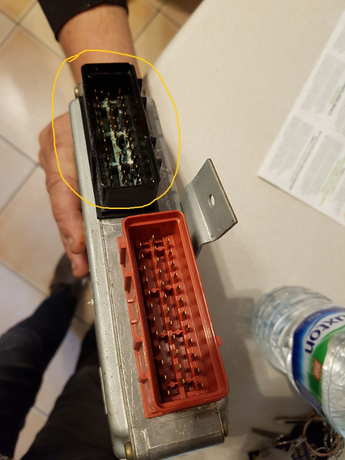

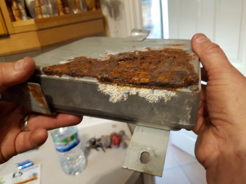

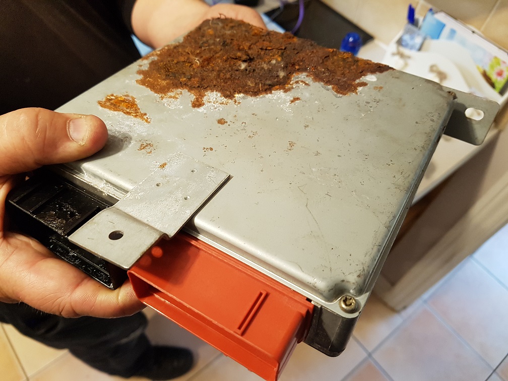

Thanks for the responses. The crank position sensor has been replaced just over a month ago.
ECU was out - we have found the culprit!!! Water had been traversing through the cabling into the ECU and then exiting at the base!!

A replacement ECU was sort from ebay for £70 and seems to be doing the job so far!

That`s had it, Rich. Broken!
Present it to the local Council in the approved and tested manner!!

yep its beyond its use by date , in the skip with that one
