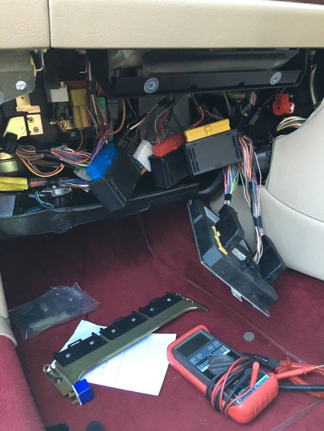

Re: central processor fault, car not starting
the large hanging down central processor unit with its three plugs, its mounted on a spring clip behind the rail of three smaller relay modules that you have to remove to get proper access
and the 20p coin is for turning the plastic stud fasteners, as screwdrivers are to ' sharp ' and chew up the plastic, a coin is just right and i always have one in any car for such fixings, lol
