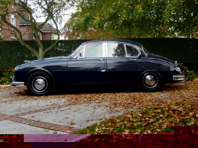

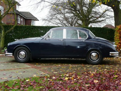

Further to the above assessment I have now raised the back end but not as intended.
I went to see Ken Jenkins (he is only about 30 miles away), it is always a pleasure to chat to Ken but he is very popular so it doesn't last long.
We couldn't find a set of the aftermarket and 'sold by a well known supplier' springs, only one but did find a proper set of high arch springs (by proper I mean the end of each leaf has a forged indent to take a 6mm thick rubber button). I took the three springs home and compared the tension against my own springs (measured the deflection against a set load in my hydraulic press), they all came our roughly the same.
The odd aftermarket spring is a little wider and on cleaning up one of the proper high arched springs (4.5") it was badly corroded and marked so I took them back to Ken. I had been making a set of spacers incase I had to use my own springs which on inspection were in excellent condition.
So using some strip steel 10mm x 25mm I made blocks 2" x 3" by 1" deep which is now bolted onto the spring with narrower strips either side of the spring box to hold bottom plate on. This results in the axle being 2" lower (back end 2" higher).
Which do you think looks best??
Brian

The car looks better "propped up" in the second picture, Brian. Gives the impression of having had some recent suspension work done and able to ably carry some rear end load without sagging.
The first pic seems to allow the sills to be level in relation to the ground. That perhaps makes for a more mature suspension visual.
I think I favour the second visual even though I`m a dropped suspension freak.

Hi Martec,
That don't look bad for an 'ole smoker - the boy's done well.
The first photo looks as though the tail is sagging a little.
As for the stance in the second photo - to me, both the front and rear ride heights look perfect.
Now we come to the difficult bit. The rear suspension is not designed to maintain a particular ride height to compensate for variable loads. As I said, the second photo looks the business but you have not mentioned the amount of fuel and/or gas on board.
Clearly, you have mastered the art of adjusting the rear suspension ride height. You are now faced with finding the ride height which is most suitable for the use to which the vehicle is put. Sadly both the petrol and gas tanks are aft* of the axle which aggravates the situation.
On the basis that number two photo has, say 3/4 of a tank of petrol and possibly no gas I would be highly chuffed to accept that setting. With full fuel and even a couple of passengers to the rear then clearly the rear will sag somewhat, but so what. In contrast the thought of the rear being way up in the air with no load would look equally poor.

Thanks Mike and Oldtimer,
When I was with Ken he showed me two cars he had in and both had the rear end looking like the jacked up picture and said thats what it should look like.
The car is particularly heavy at present as it has almost a full tank of LPG (normal) but also 3/4 of a tank of petrol (usually 3/8 to 1/2 full) its been in since May so needs burning off. With my long legs and the seat bolted further back none can sit behind me and rarely is there anyone but me and Lesley in the car. The gas tank is bolted directly above the axle.
I expected to lift the front as well but the front spring pans are horizantal (correct) so it is staying there. That is the daft thing about these cars, there is nothing in the manual to say what the correct height should be or the correct suspension angles, just setting block and bars to adjust the suspension when its jacked up!!!!!
I was surpised to be able to crawl under the back to check the oil in the axle, never been able to do that before (mind you I have lost a stone in weight).
It felt a bit loose when I drove it today but cornered well, but it needs to settle a bit now.
