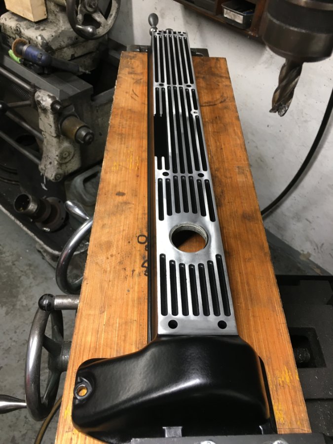

So I was gingerly prompted to the Garage (which wasn't expecting it) and left for them to do their magic, that was 3 months ago! so after rebuilding the carbs, which had misaligned butterflies and a ton of dirt in the floats ! the centre pin in the distributor had disintegrated, we gave her a full engine, box and diff service, powder coated cam covers and milled back to reveal the fins, airbox heat trunk etc, freed some brakes fixed some oil leaks and we are away, wind blowing through the old girl with all windows down, she is driving lovely but a bit gutless, so next trip is to Sigma engineering Gillingham where Peter Lander will fine tune it on the rolling road .
