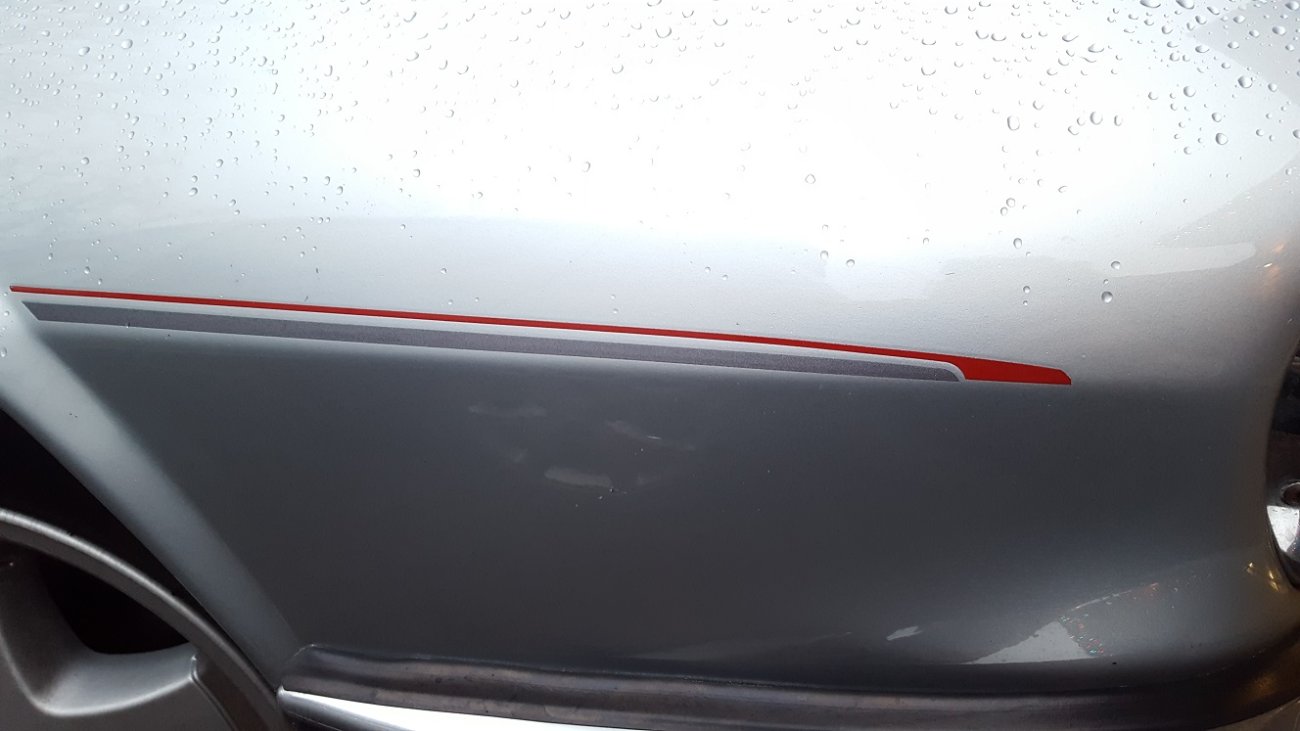

Hi Nick
It is great to hear that you are planning on some TLC for your car - I have always thought that Flamenco Red is brilliant on the XJS.
Your post prompted me to go and have a more detailed look at my own car, a 1994 MY 6.0 V12 coupe (silver frost metallic). I believe that it has its original coachlines - while the paint is not concours, and it may have had some paint locally here and there, it generally looks original(ish)! As it was originally a Jaguar UK management car, I presume the coachlines it has are as it left the factory.
Like yours, the coachlines appear to be on top of the clear coat - but their style and layout are very different to yours.
For comparison, I took the image below just now:
It shows a thin red line ~1.5mm, 2.5mm gap, 4.5mm grey thick lower line, plus a distinct finishing detail at the front. I compared both left and right wings and they are the same.
Having looked carefully at the lines, I am pretty confident that they are painted, rather than tape. This seems logical to me, as that is how we did coachlines when I worked at Bentley, and in many respects the mid 90's XJS matches up as a "junior" version of the Continental R which we built at the same time.
If it were down to me, I would try to pin down the exact spec for your car (UK, 1994.75MY etc) and get it included in the respray. I made the mistake of typing in "coachlines" into a US forum and found lots and lots of discussion about them, esp when it came to judging for concours events.... perhaps it can all go a bit too far!
Good luck with the research and the body / paint work. Please share the picture and story of how it goes - I think we all enjoy seeing how these projects progress!

Nick
The fact that you have found a part number for a coachline tape made me doubt my assertion that they were painted lines. While putting the car back into the garage this evening, I found out that, yes, they really are tape!
Next to the front LH wheel arch, there is a tiny section where the tape has delaminated, leaving the adhesive on the clear coat, but the colour upper layer having come off. So - tape is the answer, at least on my car.
And for completeness, here is how the coachlines terminate at the rear of the car.
AF
AF

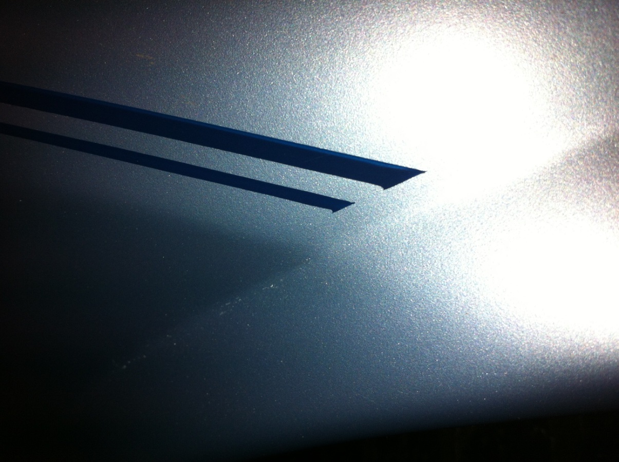

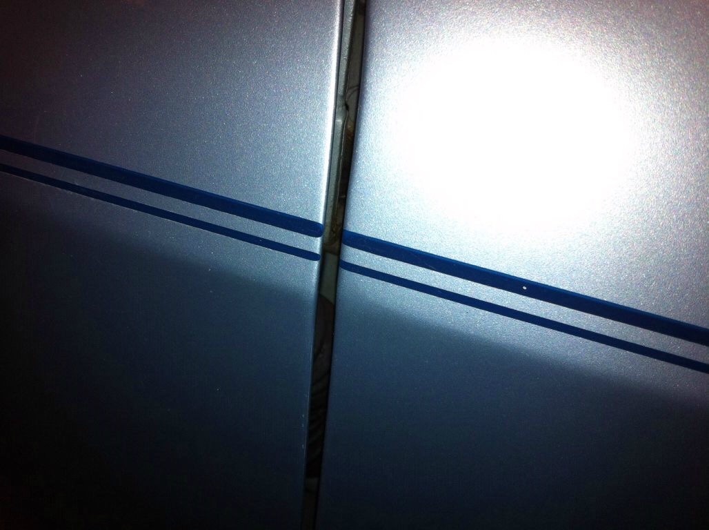

Here are a few pictures of the painted coach lines on my 1996 car. They are quite different from the stick on kind as you can see

Re: Painted coachlines -1994.75 model
That’s great David,thanks.
They look like my size.
I just need to find the correct colours.
I guess any good resprayer should be able to match them up.
All the best.
All the best.
