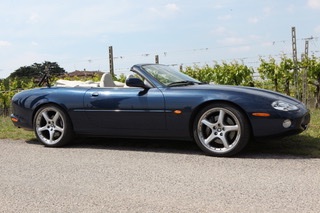

Side view at the sight where Italy as a new nation in 1861 fought the Austrians and lost the war.

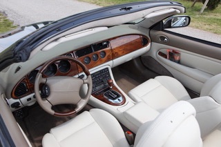

Interior view
