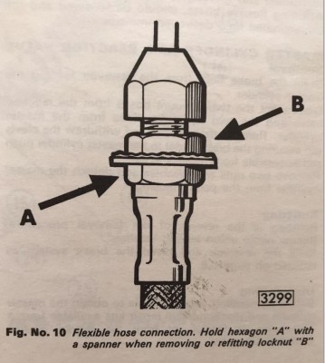

It’s imperative that you support the connections at the respective ends when undoing the flexible pipe.
The connection inside my 420 engine bay on the offside is particularly difficult to get to but you MUST have a spanner on it, otherwise you’ll wreck the brake pipe just like I did. It’s a two-person job.
Here’s the relevant sentence tucked away right at the end of the Brake Overhaul section of the Service Manual.

In fact, by far the more sensible approach is to disconnect the nut on the metal brake pipe fitting BEFORE removing the flexible pipe.
