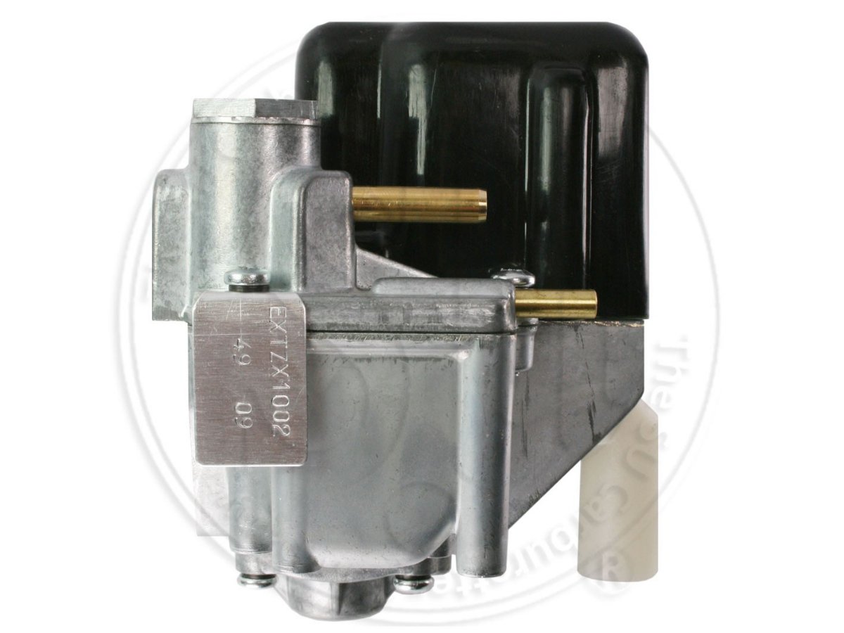

Unfortunately AUH 300 is "temporarily out of stock". But there's lots of other AED bits on Burlen's SU page:The original AEDs were a pain. The idea was good but in reality they were always unreliable. Since Burlen Services took over SU parts supplies, it is said the company has revised the AED and the units now supplied are reliable. Hence, you might want to reconsider the easiest option of simply replacing the AED. Mike.
http://sucarb.co.uk/catalogsearch/result/?q=aed
Burlen may do a refurb on your existing unit though, haven't asked yet as even since my '72MY been in the new shop still noone's been to fit the new fuel pump so don't know whether my AED's dodgy (bought car with gravity feed to the carbs -- engine running was as quiet as a sewing machine)
