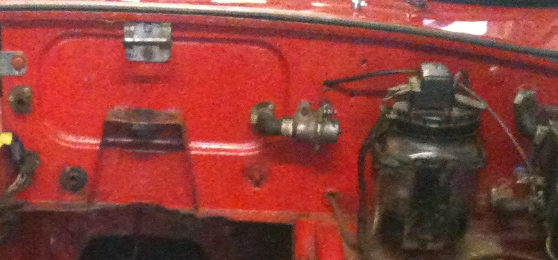

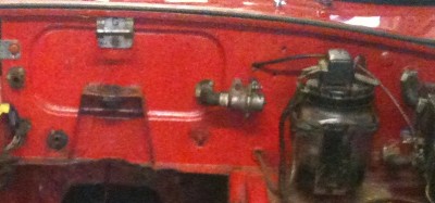

Here's an old photo of that part of my car taken several years ago when the engine was out to renovate the under bonnet area.
You should be able to see two pipes protruding to the left, the heater valve to the left of the washer bottle and two more pipes just to the left of the heater (above and below each other). Sorry the photo isn't any clearer.
