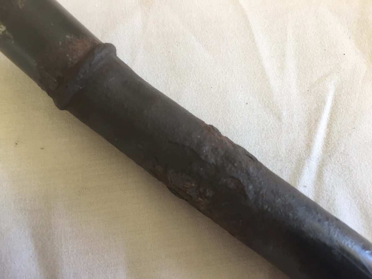

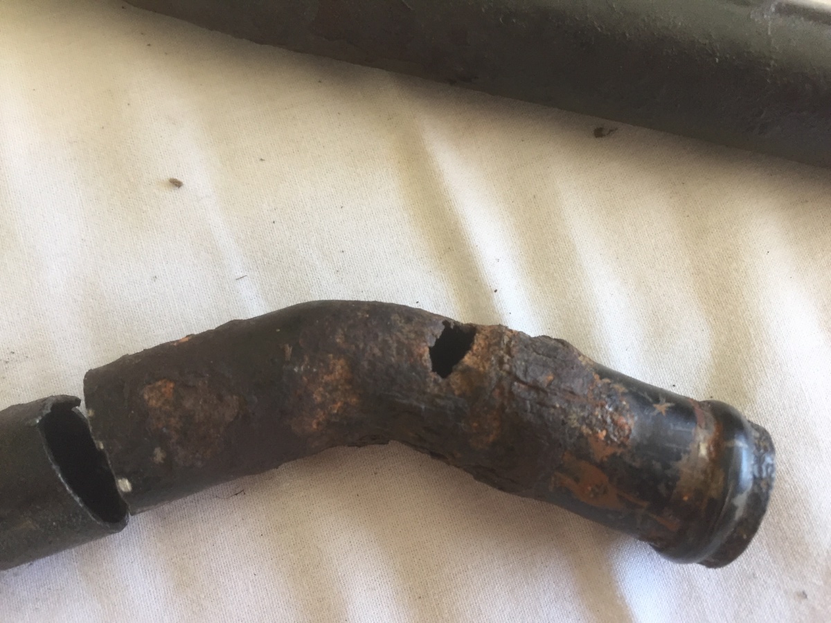

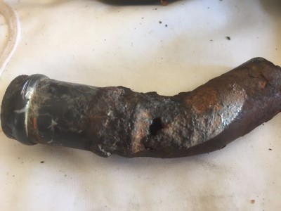

Update Part 22 :-XR849219, £46.31 in SNG Barratt catalogue( Expensive for low quality product, clearly a Jaguar sourced part)This is the second coolant tube ( Thin Walled Conduit) to rust away due to exposure to the elements at the front underneath the engine and radiator.The tray under here provides no protection, worth taking off the tray to see the condition of the metal coolant tube under here.

It looks like pipe XR849217 has a hole in it also, lost water on the drive today, shocked. My car is booked in to Stokenchurch Services, 25th, to have pipes XR849218 and XR849219 replaced which I've received From SNG Barratt ready, XR848271 had already been replaced after failure in the middle of France. So all four thin walled pipes located under the engine have rotted. Pipe is £98.00 plus postage from SNG Barratt and is a Jaguar sourced part. All I can say is I would strongly advise anybody with a car of my age, 2005, to remove the under tray and check the condition of these pipes on the cooling system. Print out the assembly diagram for the S Type Diesel Coolant Radiator Hoses and Pipes on the SNG Barratt site to identify the pipes.
