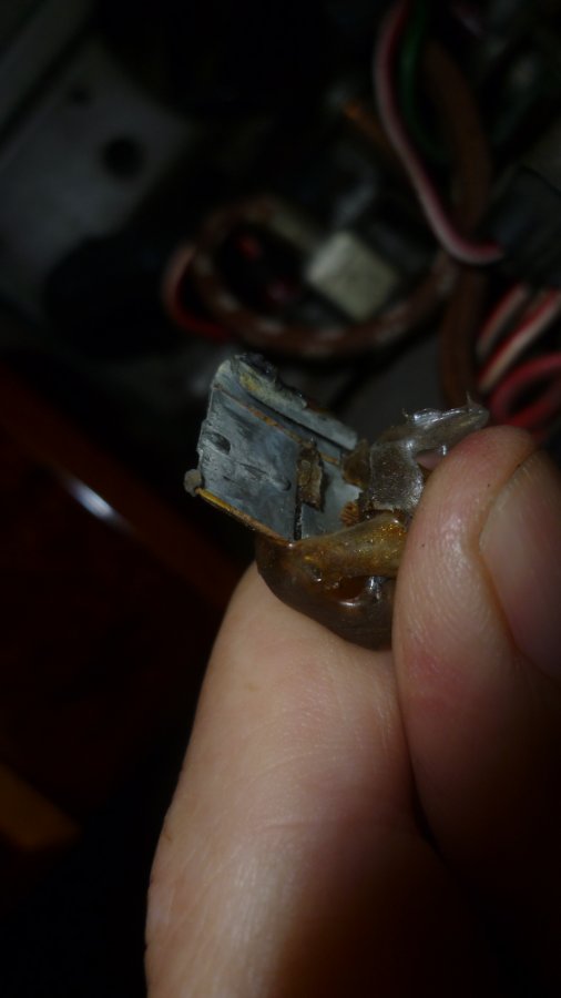

it got to the point when nothing would work. I lowered the instrument board. One of the spade terminals had fallen to bits. I have now fixed that and things work again. I am not sure of the charging though. I will take some measurements tomorrow.
Peter

unusual but a likely culprit. That would be incapable of passing any real current.
Alec

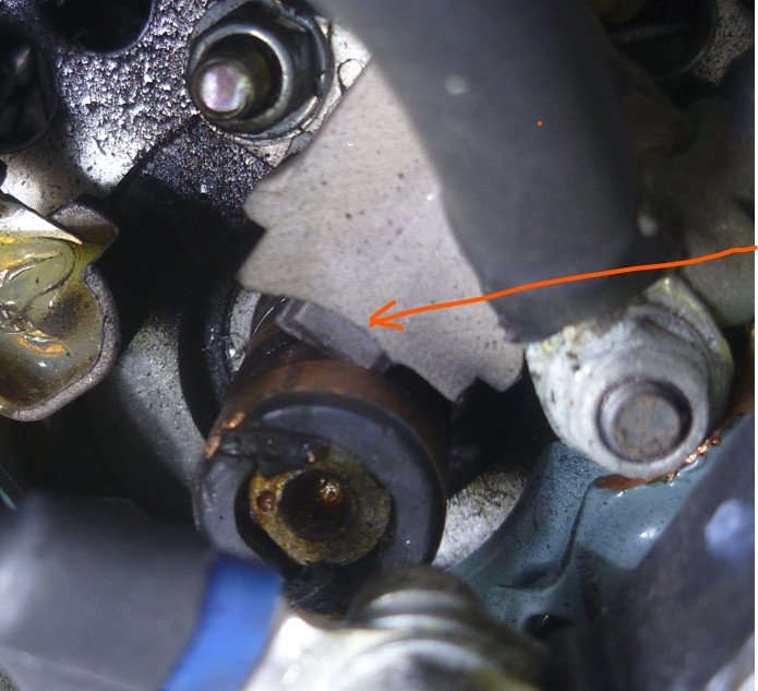

Re: Alternator / dynamator??
I was hoping the regulator would be recognisable as a Lucas, Bosch or other mainstream source. I was a bit stopped in my tracks though by the brush, which runs on its corner on the slip ring.
