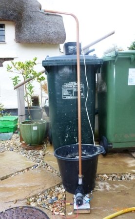

Outlined below are the two methods I used testing the auxiliary heating pump from my car,I feel method 2 the more representative. As I have not be able been able to find any figures on the pump fitted to our cars (086) I feel this is the closest Iam likely to get without knowing resistance through the heater matrix (new) and the associated pipe work, leaving aside a proper test rig.
First method testing output. Discharge measured into a bucket
Pump inlet connected into bottom of a bucket water head 50 mm above inlet.
Pump discharge via 20 mm ID pipe standing upright 90° bend at outlet.
First attempt at 1 m head pump would not discharge/lift. Reduced head in three steps of 50 mm until pump discharge at 850 mm head.
Giving approximately 0.083 bar head pressure.
Average of two runs discharging into a bucket.
11 L in 45 seconds = 14 L a minute.
Second method testing output discharge measured into a bucket.
Pump inlet connected into bottom bracket.
Outlet vertical pipe pulled 90° bend at outlet height 13.5 mm ID the same ID as pump outlet.
Set at 1 m head (0.098 bar)
Average of two runs.
10.8 L in 1 minute 32 seconds = 7.2 L a minute.
Maybe of interest. Pump connected as in method two.
Outlet via 18 mm ID rubber hose and approximately 200 mm head 0.02 bar.
Discharge 12 L in 35 seconds approximately 20 L a minute.

Be for installing the repaired auxiliary heater pump I carried out some more flow tests.
This time only using 13.5 ID tubing as it is the same size as the pump outlet.
Results are below.
Retest of flow using 15mm copper pip (13.5mm I/D) Method of measuring discharging filling a bucket. level above Inlet to pump 150mm
(a) 1 Met head 11let in 60 Sec = 10.8 Let Min
(b) 1 met head 10let in 56sec = 10.2let Min
Average of two 10.5let Min
(c) 850mm Head 11let in47 Sec = 13.8let Min
(d) 850mm head 11let in 50sec = 13.2 let Min
Average of two = 13.5 let Min
