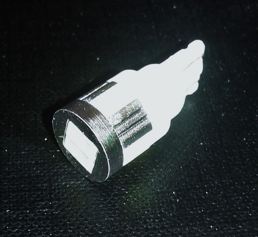

Here is the link for the LED lamps. They look much more in keeping with the HID headlights and really freshen up the appearance. These are pure bright white without any blueish or other colour tint. The MOT man will look to see that the new LED lamps are bright white with an appropriate colour temperature of 6000K. Any hint of colour tint at the front end of the car could cause an MOT issue. http://www.ebay.co.uk/itm/271463601360? ... EBIDX%3AIT

I originally bought a pair of LED 501 bulb replacements from eBay, but despite being advertised as fitting our model car years they did not fit as they were too long to allow the holder to engage correctly. So, lesson learned I followed Mike's eBay link and bought a pair of those and they were fine. 'Fit and forget' I thought, they are LED so should last for ages. I had occasion to check them the other day and BOTH had failed. Not even a year yet. Grrrr...
I have now fitted a pair of "Halfords 501W5W Filament LED Upgrade Bulb". These are £12 a pair, so more expensive than the Ebay ones, but do have several advantages: you get a 3-year guarantee; the outline is exactly the same as the filament bulb it replaces, so no problem with the fit; it has a single forward-facing chip protected inside a plastic 'bulb' outline (not bare chips like the eBay one); Smart electronics make it CAN-BUS compatible with our lighting system and allow it to be plugged in either way round and it still works!
